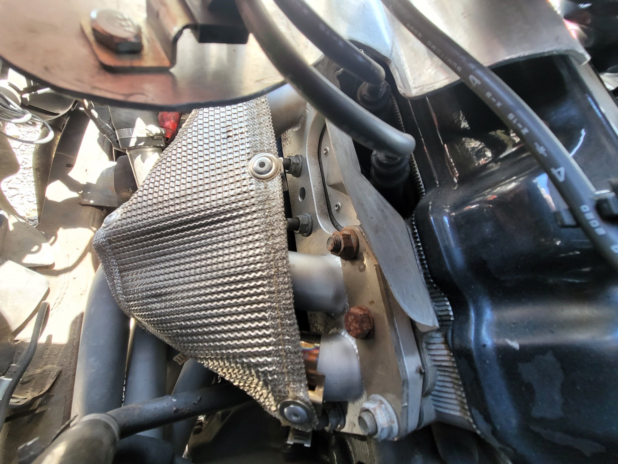

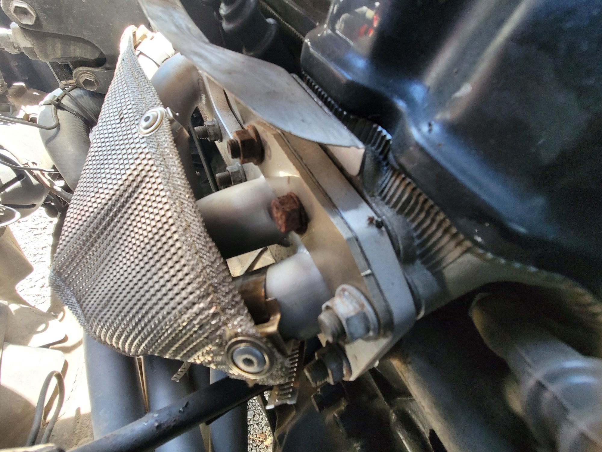

I ran one of these, I believe the 6x12 across the 4 primaries on my 22r header. They are pretty adaptable and give you a standoff between the heat shield and the header. Haven't loosened up. I've heard maybe wrap isn't the best way to go, but haven't tried it myself. https://www.designengineering.com/he.../pipe-shields/

Here are some photos of my setup...the heat shields themselves are pretty spendy, but there are probably lots of ways to just use the standoffs with a cheaper heat shield. I was trying to solve the problem I created of putting my air intake directly over the header. The heat shield on the header definitely helped.
