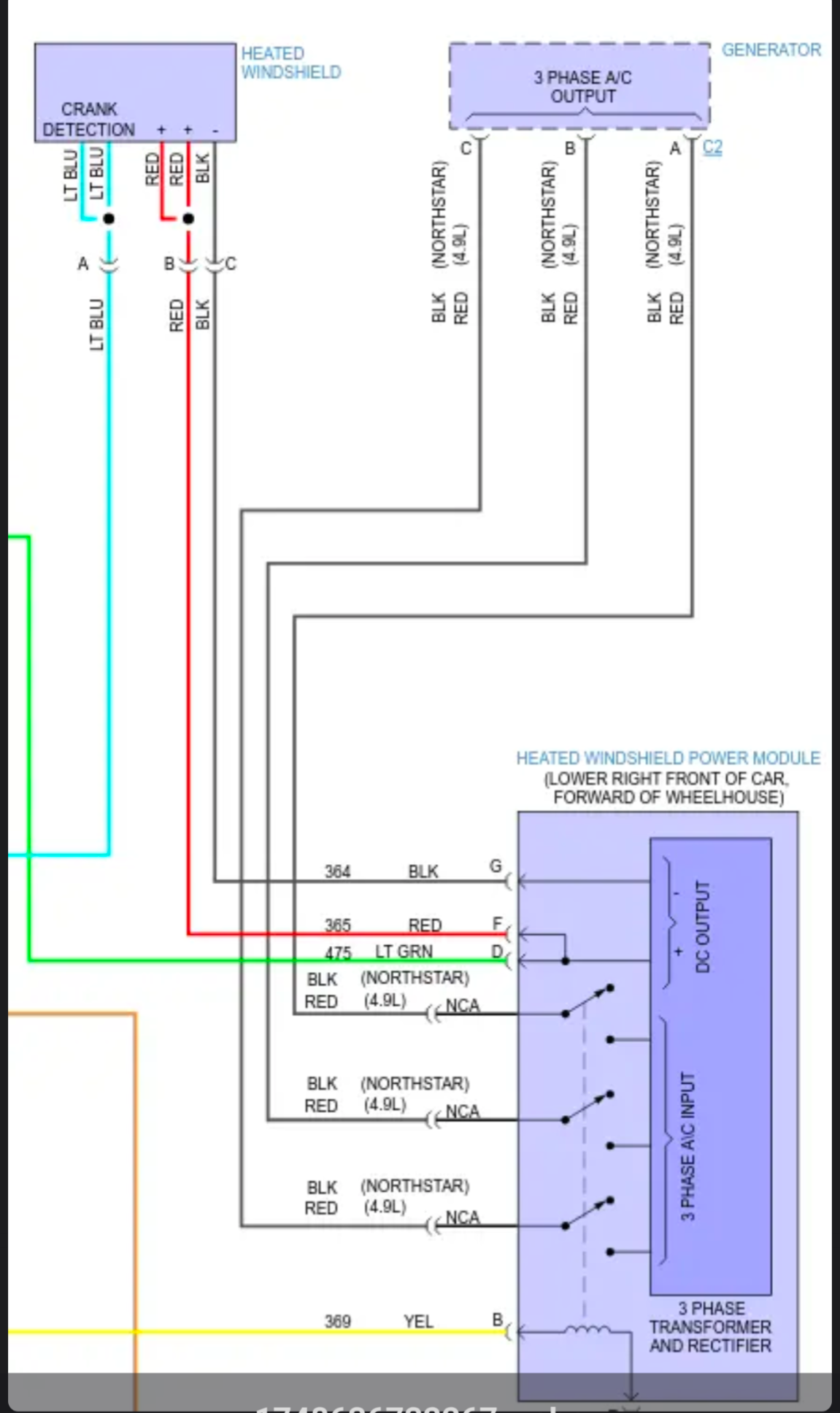

I have learned that the pins are three phase AC output for the Cadillac windshield heater system. You can leave them unconnected.
As the diagram shows, when the windshield heater is not on (which is almost 100% of the time the car is being driven) the relay is open and the pins are effectively unconnected.
I covered mine in adhesive lined heat shrink but am debating cutting them off.
