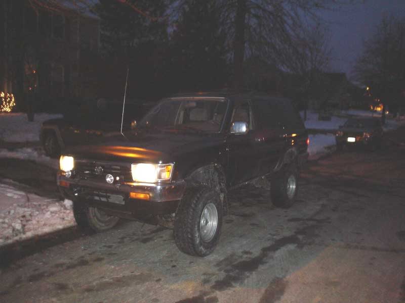

Well I cant let the third gens have all the fun.
I installed some 92 FJ80 springs in the rear of my 95Runner today. I had to be very creative to get these things in. I ended up using an 11.95$ spring compressor from Harbor freight and it did the job. That tool was really not happy trying to compress these Land cruiser springs. However we were able to compress them to almost stock size
Before we changed the springs I measured 12" from the top of the rim to the fender lip after the change I was at 16" . I also have a 2" body lift on my rig and prolly about 200lbs in the back of my truck right now.
Here is some pic's my camera doesnt do good night shots so I used an image editor to lighten up the pic some I'll get some better ones after I put my BJ spacer's on. Anyway's No more saggin ass at least on my truck.
