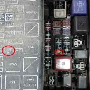

I am in the middle of a deckplate mod for a 2.7L 2001 Tacoma. It is going great, I can't wait to fire it up. I was planning on pulling the EFI fuse when I'm done, like I've read you should do. I've read that the computer will relearn on it's own if you give it some time (a tank or two of gas), but it moves along faster if you reset the computer by pulling the EFI fuse. Is this correct? And I'm not sure which fuse to pull, since the writeups i've read are for the 3.4L and it is a 15A fuse that you pull. The only EFI fuse I find is a 20A fuse. Please see attached picture with the EFI fuse circled in red. Is this the right one to pull? Thanks.

That's the same fuse I've been pulling for my ISR mod.
That's also the same fuse I pulled yesterday that cleared my check engine light.
I'm not sure what everyone else will tell you but I think you've got the right fuse.
