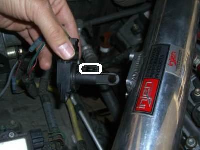

This morning I pulled off my intake(after market, Injen) and noticed that my air sensor was very dirty. I cleaned it off with a tooth brush. I still dont think thats the problem but you never know.

The air sensor outlined in white was super dirty!!!!!

you spray it with electrical parts cleaner too when you cleaned it? and a q-tip?
Edit: isnt there another diode down the center of it too? i cant remember, cleaned my buddies a while back ago and cant remember, if there is clean that one too.

I will also get some eletrical cleaner spray and clean the air sensor. You are right, their is a little sensor inside.
If the outside sensor was that dirty, the inside was will be really dirty too!

yeup, my buddies was caked with crud on it, once it was cleaned the p0171 code went away. and he got way better acceleration out of it.
