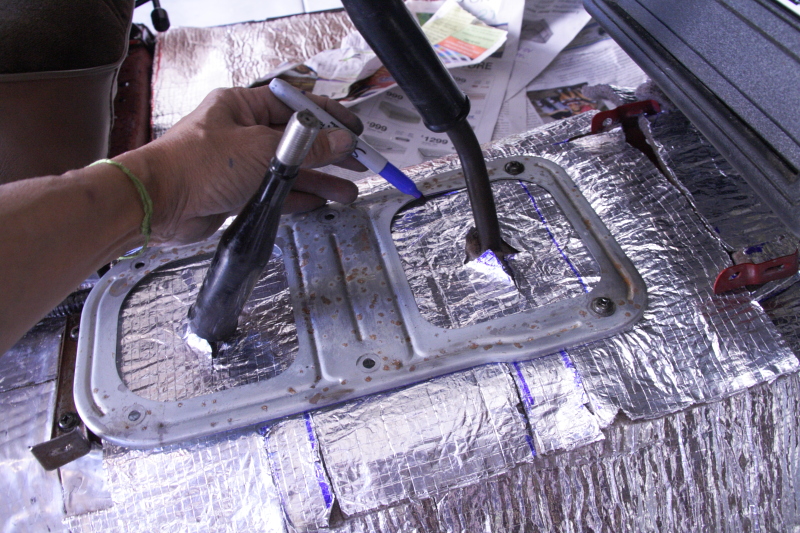

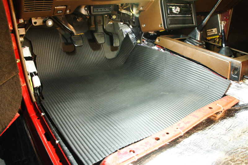

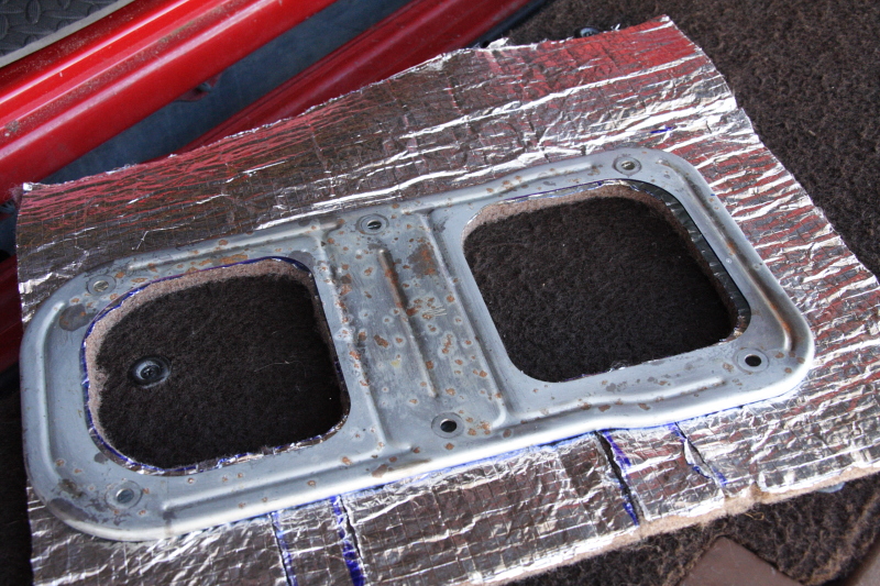

This ^^^ but three layers:
The visible vinyl boot
The rubber boots
Then the metal plate.
Then I added fourth (Thermal Insulation)
and fifth (3/8-inch exercise mat) layers to mine...
Attached Thumbnails Excessive Heat from 4x4 shifter and console-010-1.jpg   Excessive Heat from 4x4 shifter and console-020-1.jpg   Excessive Heat from 4x4 shifter and console-030-1.jpg   Excessive Heat from 4x4 shifter and console-20121107_014.jpg

Great idea Ray, extending the insulation right up to shifter levers. I'm going to do that. I'm also switching to synthetic just to keep tcase temp down a bit.
Aside from sound deadening, and the exercise mat, I also have the thermal insulation from firewall all the way to foot of left side because that's above the exhaust plumbing. Still so much to do, not enough time.
