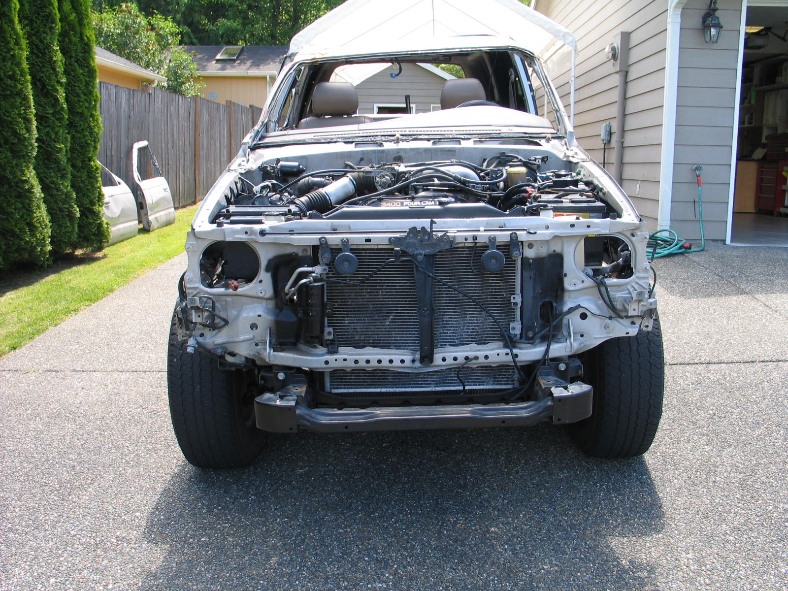

So, how do they build 4Runners in the factory that makes them so difficult to take apart or service? Do they put the engine & drive train on the frame first and then body-on-frame, then all the wiring etc.? From an electrical engineer's point of view this is a nightmare which invariably adds service cost. You wouldn't build the internet this way, but then again it went through several evolutions before it got where it is today. Same with computers. Oh, back to the initial subject, is there a smart way to remove engine and tranny and transfer case all in one piece? Can it be done? How about removing the transfer case from the tranny which is easier to access? The book says don't do that but I'm just wondering why not?

eddileephd & arjan - thanks for the additional input. I have access to whatever I need to do the job, and may cut out the body steel in front of the radiator on the wrecked rig, or possibly remove the steering box to aid in removing the engine/tranny/transfer case as a unit.
If the truck is destined for the scrap yard, get the sawzall out and go crazy. I cut the whole front core support out and literall, the engine and trans popped out in 5 minutes.

I've been delayed on this project and thank everyone for their input. Cutting out the front end seems like a great idea. But, I still have to remove the old engine & tranny from the good 4Runner but it may give me the education and insight I need on how things fit together. I won't be using an official FSM. On a related note my son-in-law says the front frame core may be saleable to someone looking for replacement body parts so I shouldn't do it. I say what the heck, it can't be worth that much? Once I strip what I want off the wrecked unit it will go to the heap except for maybe stuff that might be saleable.
