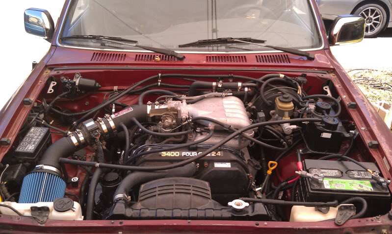

I'm not sure if the 99 4Runner EVAP canister is different than the 96/97 canister, but I mounted my 97 4Runner canister on the driver side fender (sorry, they're not the best but they're the only ones I have that show where the canister is mounted).
(long story, don't ask...)
