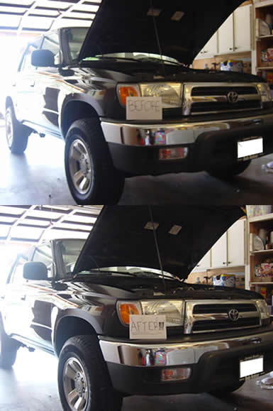

pretty easy. I jus removed the 2 10mm bolts and wiggled it out. it may seem like it won't come out...but it will. Attached are some before and after pics. Looks great doesn't it? Thanks for the help, guys!
Old May 28, 2003 | 12:31 PM
rimpainter.com's Avatar
Joined: Jan 2003
Posts: 10,916
Lol, I know you are kidding about those pics right?
