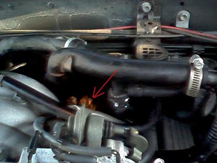

Dr. Z, i read some of your previous posts, and the sensor with the green/blue wire was behind the intake manifold, but if you say its underneath the plenum, i probably have the wrong one. There's a pic of the sensor i think it is, but i might be wrong.

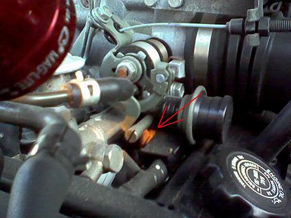

and a pic of what looks like a sensor under the intake plenum.
That sensor is_probably_the right sensor. However, without a shop manual or a multimeter to test it, I can't say for sure. Since it did nothing to the idle speed when you set it up, it's possibly not the right sensor or you installed it incorrectly somehow. I think the other item in the 2nd picture is a fuel injector, but it's hard to tell from the fuzzy focus and angle of the shot.
I still suggest what I said previously about contacting a local Toyota shop.
Hope this helps.
G

I checked my wiring diagram and green/blue is the correct colour. It connects to terminal B4 on the ECU. The ECT sensor should have 2 wires, green/blue and brown/black. The temp guage sender has a one yellow/green wire.
