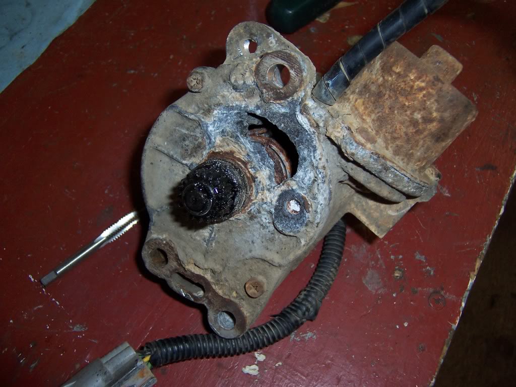

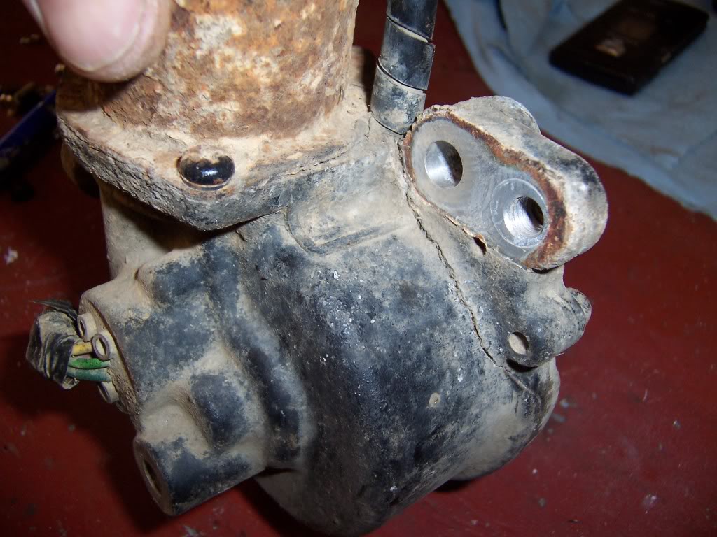

so my light was blinking ever since i got my 4runner. so today i wanted to figure it out. first i noticed a nice crack in the caseing, then after pulling the thing out.. it has a huge hole in it. so its pretty much junk. luckily i had an extra.

Holy crap! That is your actuator motor?? I don't think that is what is fragged on mine because I can hear it wirr when I hit the button and the motor is off. Guess I will find out tomorrow when I pull it off.

i was so shocked. somehow the metal just ate away. damn salty roads. yea best thing would be take it out. hopefully it comes out easy!
