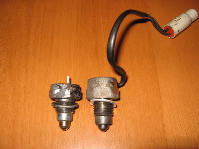

Does anybody know (or would anybody be willing to check and verify) what size socket is needed for the indicator switch that's on top of the e-locker?
Supposedly it's the same part as the back-up lamp switch for a manual trans, so that would work too.
It looks like a 26 or 28mm, I just don't want to buy the wrong one...
Thanks

They are the same size... My factory e-locker switch was missing a pin and rather than spending big bucks on a replacement, I used a reverse light switch. They look slightly different in the amount of travel, but both have continuity at the same point of travel in the motor arm.

Wow... Did I really not think of that??
But yeah, I'm planning on using a reverse switch too.
