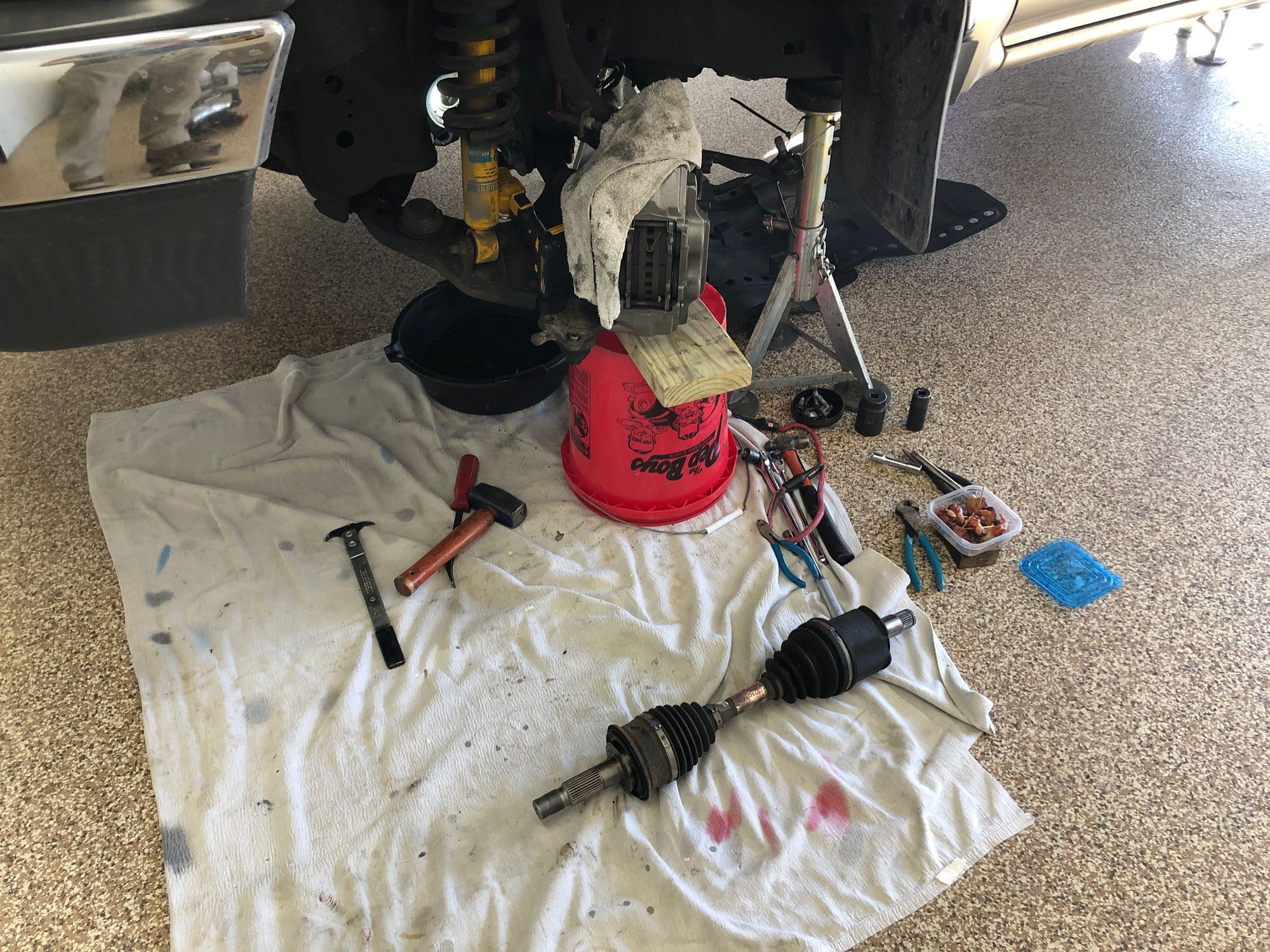

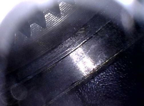

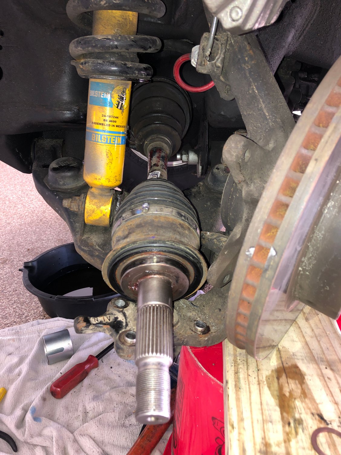

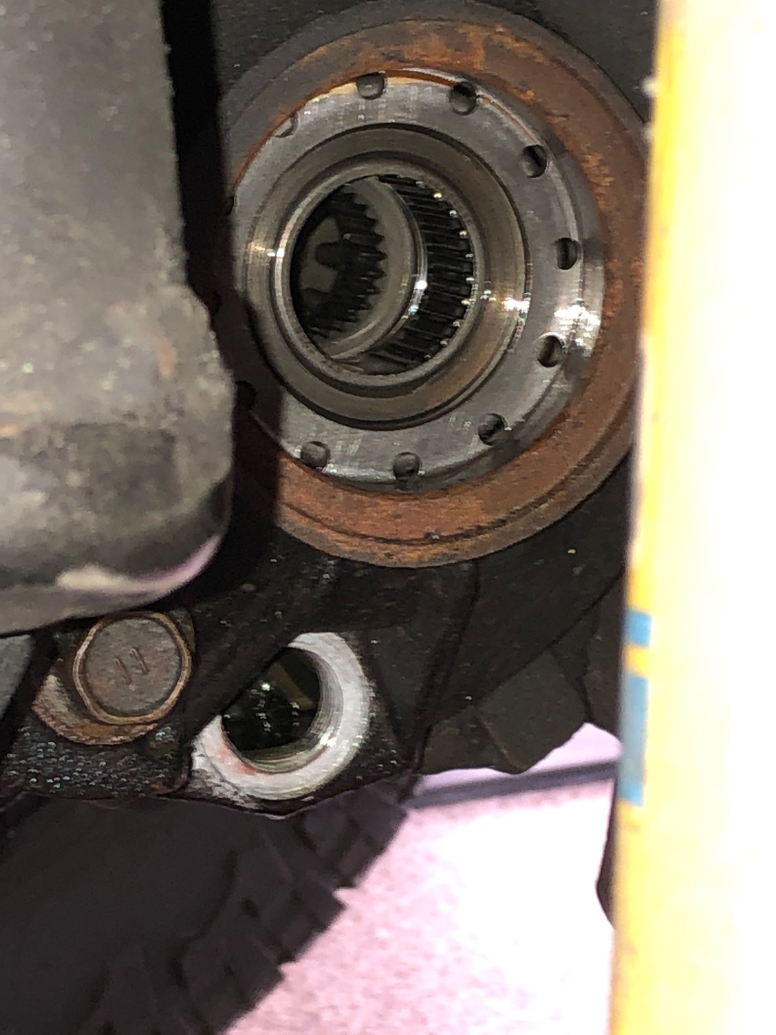

I installed the ECGS bushing today. I’ll post some thoughts & pics in the next few days.

My driver’s side CV joint had a significant amount of play. Although I installed a new set of Toyota remanufactured CV axles last year, the front diff still has 454,000 miles on it.
With the ECGS bushing in place, there is zero play at the inboard CV joint. The next day I put 400+ miles on it, 30 of which were driving on the beach. No issues.
Andreas
