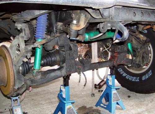

Just for you - I went and pulled out my front diff (technically it's not a third member) so I could take a picture....
This is what comes out when you pull the front diff:
Old Nov 26, 2004 | 11:25 AM
Flamedx4's Avatar
Joined: May 2004
Posts: 3,291
From: 100 miles offshore as much as possible, & Springfield Oregon USA
...and this is what the front end looks like with the diff missing (the lift makes for a bit more room to work) on 86-95 models.
