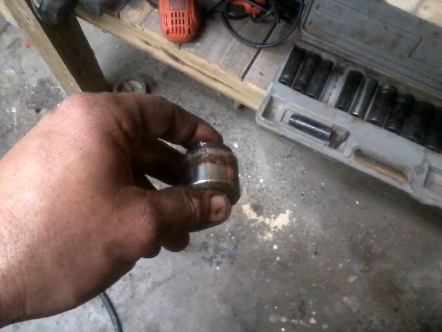

I have seen the pistons freeze inside the caliper on previous generations when sitting for long periods of time. The pistons will rust to the caliper. From now on when I work on a truck, I just replace the complete assembly, calipers, brake pads, and sometimes rotors. My truck the pads had created a rust pocket in the rotors and when you hit the brakes, it would pulsate as the pad went into the pocket. It was $20 to have them turned or $25 for new rotors. On my 01 runner I think I had about $150 into disc, pads, and something else if I recall right. A trucks condition will go down hill fast just sitting.
While looking up some other information, I came across a picture of where a piston rusted inside the caliper. Not sure what your calipers look like but am sure it is a similar setup.
