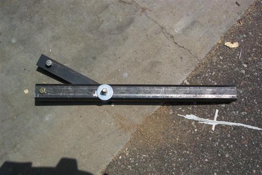

So what is the nature of your problem? Is your home-made pulley holder bending/slipping? Can you not get enough leverage on your breaker bar to loosen it? If its the latter, a hydraulic jack handle will slip over the end of most breaker bars giving you bookoo leverage. I used the pipe from a High-Lift jack.

Here is what I've tried:
heat, penetrating fluid, starter, pulley holding tool w/ muscle
The tool is awesome, but the bolt just rounds off. The same happens with the starter, it rounds the corners a bit and the socket falls off.
This is my tool:Is the crank bolt...-100_1883-custom-.jpg it works like a charm.

Find,beg,borrow,rent a 1/2 air impact and save your self a ton of hassle. Same goes for a air supply if you do not have a compressor, or decent size air tank. If your stuck with "manual" and your biggest problem is "holding the crank from turning". There is the old soft rope into the combustion chamber trick so the piston/crank will not turn. Then a strong socket and lots of leverage and when it breaks loose, dont fall and break something else. Good luck.
