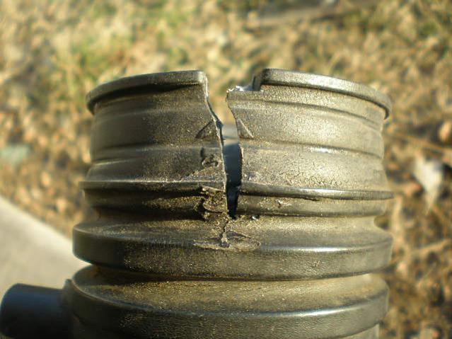

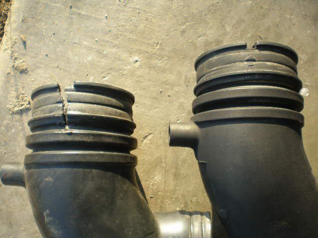

So after searching for a while I finally found a new intake tube for my 97 3.4 at a salvage yard for $10 what a deal right? My old one had developed a crack right at the top. Does anyone know why this happened? Also how would I keep my new(used) one from eventually doing the same thing? Did it just dry out of what, has anyone else had this happen? It cracked right in between the alignment notch for the throttle body. Maybe I should soak the end in armor all or something for a while? Thoughts, suggestions?
Attached Thumbnails Cracked intake tube, Why?-p2180066.jpg   Cracked intake tube, Why?-p2180067.jpg

Two things cause this.
First, over tightening. People think you have to crank the clamps down as far and as tight as they can go. DO NOT DO THIS!
Second, rubber by nature gets hard and brittle over time from heat and other factors. 3.0L engines have this exact same problem, and they all split in the same exact place.

Might also check your motor mounts. The engine movement puts stress on the intake tube. Air box is bolted to the body, engine moves and something has to give. Usually that movement is absorbed by the flex in the tube, but...with either less flex from old rubber or more movement from the engine or both, stuff happens.

Another very good point. How do I need to look at the engine mounts? What signs of wear am I looking for? Hey DeathCougar how is it that over tightening the clamps does this to the tube? Not that I am doubting your knowledge but I am curios?

For an auto and a quick first check, I would open the hood and watch the engine move as you power brake in 1st gear (4WD low if you have it) and reverse. If the movement looks really bad one way, check the mount on the side away from the movement for separation.
