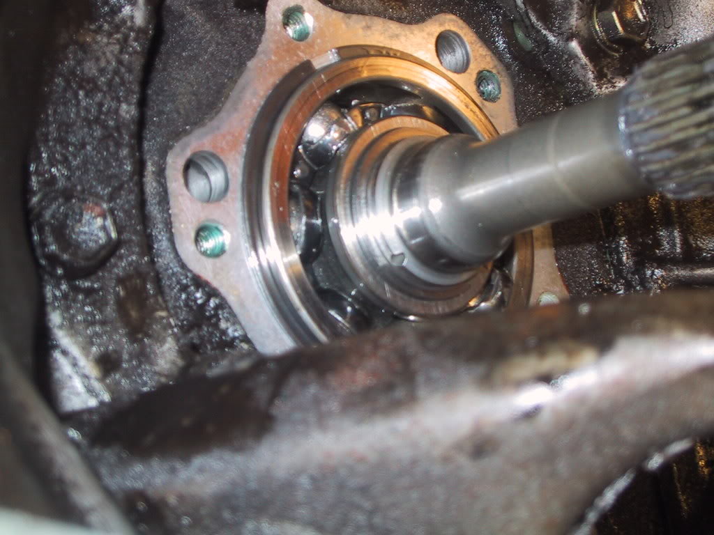

Sounds identical to my problem. It turned out it was the output shaft bearing($70 at the local stealership)Name:  IMG_0006-3.jpg
I put a new clutch kit anyways and also a good idea is to pick up a new seal when removing the shaft bearing. You may or may not need it but it's only $8 and will save you a couple of days if yours gets damaged.
The bearing was a bitch to remove and we had to use heat and burn it out. Scored my gears in the process and ended up buying a used tranny in the end. Go SLOWWW man and you should be allright
