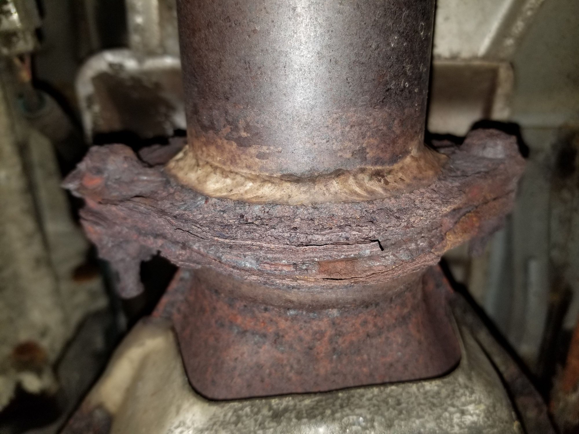

This is what i have to deal with at the Cat.
Love living in the N/E
This one is on there good.
Good thing I'm changing out the exhaust.
