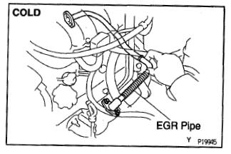

Dale, I have a blockoff plate on my exhaust manifold where the EGR would have attached on my 1996 4runner, but the EGR was only used on the 95.5 T100 with a 3.4L motor AFAIK. No 4runners with the 3.4L motor ever had an EGR valve on them that I've ever seen.
If you did have one you'd see something like this on the driver's side exhaust manifold:
