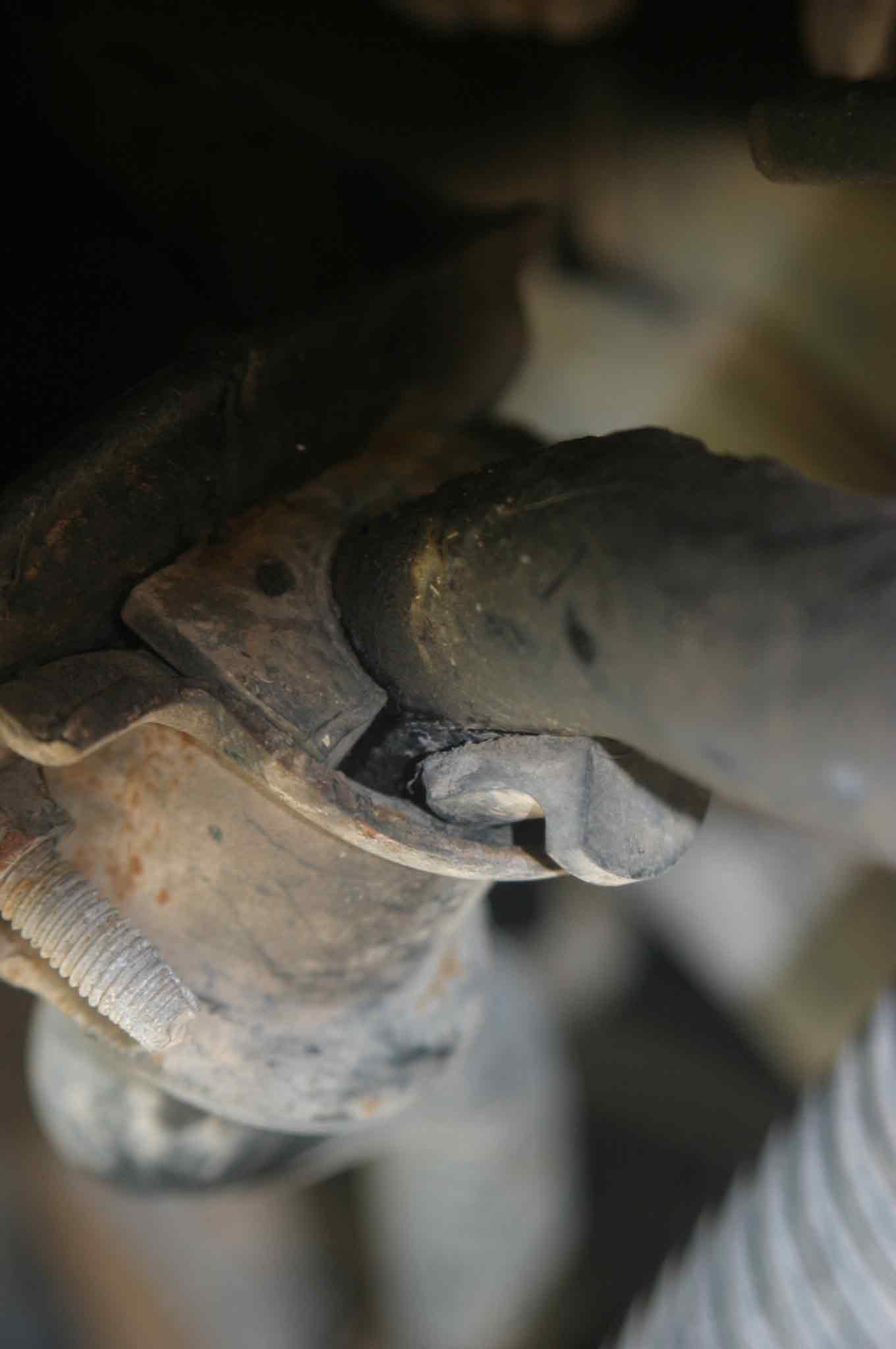

This certainly isn't helping...i wonder if this is the whole cause of my troubles or just part of it?Cause of Roll/sway at highway speeds?-img_1007.jpg
I inspected the end-links and they appear to be solid, but i am not sure if they are intalled correctly; the bottom part that connects to the frame is sharply angled towards the frame where it is connected. Without seeing another end-link, i can't tell if this could be an issue or not. It seems to me that parked on level driveway that this joint should be in a more neutral position. Hope this makes sense...

Originally Posted by kpudden
This certainly isn't helping...i wonder if this is the whole cause of my troubles or just part of it?Attachment 67416
That D bushing in the picture you attached is definately bad. You should replace it. I just replaced my sway bar bushings with Toyota rubber ones because the aftermarket polyurethane ones squeaked and never fit quite right. That bushing may be the cause of your swaying because if the bushing is worn (as yours is in the picture), the effectiveness of the sway bar is reduced because it is free to move around too much. Also you should check the condition of the rear sway bar bushings and endlinks if you haven't already.
