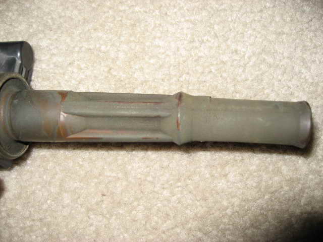

Also, here's a couple pics of the boot. Hopefully you can see the discoloration and the line inside.
Attached Thumbnails Can anyone diagnose this problem?-img_1260a.jpg   Can anyone diagnose this problem?-img_1261a.jpg

From: san diego via michigan
are those pics of the coil or ?
