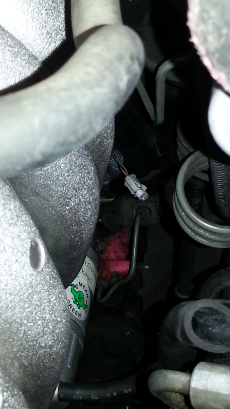

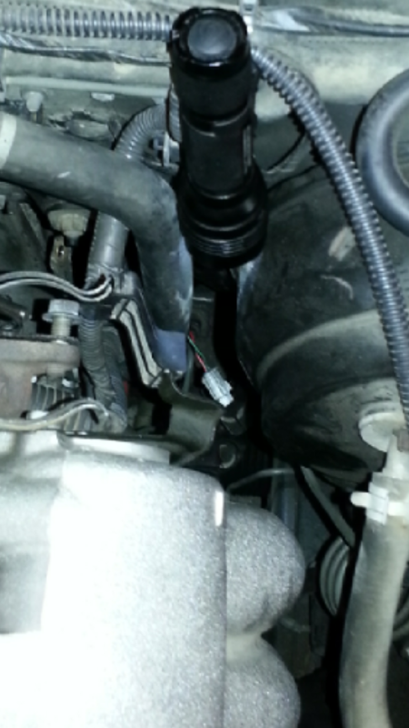

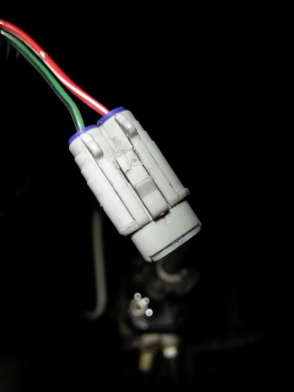

The 2 pin / 2 wire harness that connects the wire harness from the body to the front diff got hung up on the steering shaft at the rack and was ripped apart, now I don't have 4wd. The plug that plugs into the switch at the front diff (90980-11250) remained but the other end was yanked off of the harness connector and is gone for good.
I'm hoping someone has knowledge of what the part number is for the plug housing that goes to the body harness, or hoping that someone with a 4wd 3RZ can unhook their plug real quick and get me the part #.
The plug in question is, if your facing the engine, back to the right and generally straight down by the clutch slave cylinder / starter area.
Here are some pics of the body wire harness that is missing the plug I need the part number for, I looked all over this plug and can't find a part # on it...I was hoping to maybe cross reference the body plug # to the actual connector I need.
If possible I'd like to avoid cutting the frame plug off and having to ScotchLok them or butt connectors.
Your help is appreciated and thanks in advance!!

Just get two pins solder them heat shrink them
Heat shrink over the whole plug electrical tape over top your done.
That is what i would do.
Be a long time till you find a part number.

That is essentially what I had in mind, I was just hoping that someone with a 4wd 3RZ could do me a solid and check theirs for a part # (fingers crossed).
Junk yards around here, at least that I have found so far, don't seem to have any Tacomas intact or they are/were Pre-Runners anyway.
Maybe if anyone knows of a 4wd 3RZ in their local Pick-N-Pull they could pull that wire off for me.

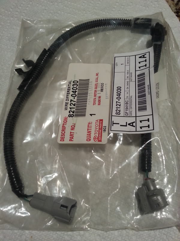

PNC 82127? Part # 82127-04030 is labeled as "WIRE, DIFFERENTIAL". Is that the wire you're looking for?

Hmmm....looks like a good candidate, for $11 I will take my chances.
Thanks.

Woo Hoo!!! Although I have not actually plugged it in to confirm 100% I can tell already that the part is what I was looking for and I can't thank MudHippy enough.
The harness was actually cheaper (online) than the individual plugs, pins, wires, etc...$11 well spent!!!
