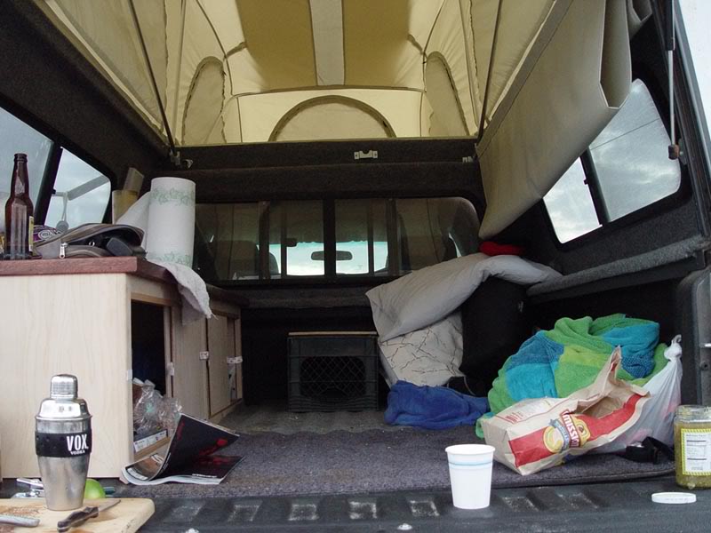

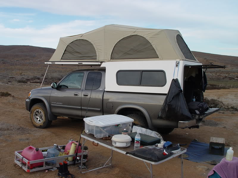

His camper connects to the bed directly. Its more like a camper SHELL with an expandable top. We made the cabinetry...
I don't know the correct terminology of the external camper mounting methods or components, but, I think that is the way to do it. I know my buddy has drilled holes through the floor of his camper, through the bed and through the frame... but, I dont know if thats the 'correct' way of doing it.
Here's what my dad has. Its really lightweight.
