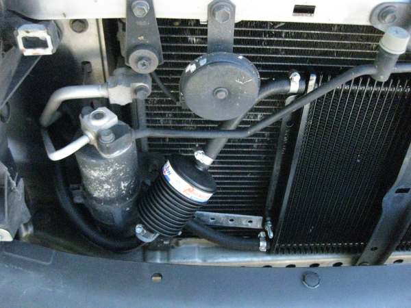

I installed my 4544 Tru cool
Hey guys,
Thanks to all of you DIY folks I have braved up and installed Tru-Cool 4544 unit 20,000btu. I'm running 145F on a highway and highest temp topped at 169F. I have also installed Magnefine 3/8" Inline Magnetic Transmission Filter on a return line. Here are my pictures.
Thank you all.
Attached Thumbnails Bypass the OE tranny cooler?-img_7039_.jpg   Bypass the OE tranny cooler?-img_7041_.jpg

Maybe in the future you might think about moving that trans filter out from behind the grill? It's going to suck having to pull the grill every time you need to change the filter. Just my opinion.
