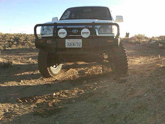

Yesterday i was out wheeling in the hills around my house. I was in 4 low 1st gear on a flat pice of road and all of a sudden Snap! I open my door and see the drivers side tire in a place that it should not be. I knew that the lower ball joint broke right away.
Luckily we found a somewhat easy way (about 1 mile of whoops and mud) to get to my truck and we also found a tow truck driver that had a sack and drove there. I was about 2 miles from my house on dirt roads.
I broke the ball joint about 3pm, and i finally had the 4runner in my driveway at 9pm.

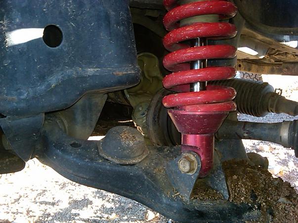

I only have a few pictures, and they are after i got the lower a-arm out of the dirt on a jack. now i get to fix it In the pic with the coilover you can see the ripped apart c.v. joint and milky oil too.
Attached Thumbnails Broke: Lower Ball Joint :(-img00011-20091208-1527.jpg   Broke: Lower Ball Joint :(-img00012-20091208-1528.jpg   Broke: Lower Ball Joint :(-img00013-20091208-1529.jpg

Well side that broke was the original one so it has 216,500 miles on it. I really would urge people to change them by 200,000. because if it broke on the freeway you may not be able to tell about it.....
And i am trying to fix it now so in the pic with the cv joint, is the cv bad because it pulled apart under the boot? It seems like that should not have came apart

Did the ball joint separate or did the bolts snap?
Old Dec 10, 2009 | 06:45 AM
j-money$$$'s Avatar
Joined: Jan 2009
Posts: 166
the Ball Joint separated. I have everything off, hopefully its back together tonight
