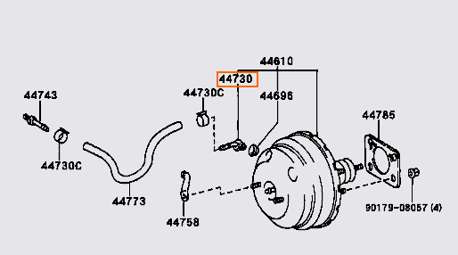

Its a common problem in these trucks. It is the brake booster vacuum check valve. It builds condensation and the valve freezes closed when it gets old on a cold morning after sitting. you cant buy this from a parts store and the oem part is $40. What I did with mine last year was to remove the check valve and soak it in WD40 from both ends. The lube is hydrophilic so it will displace the water/ice inside as well as lubricate the valve. Knock on wood, hasnt happened again since then.

Picture of said valve?

Originally Posted by cjm
picture of said valve?
Here you go. It is part number 44730-60060 labeled as 44730 on second diagram. Applies to '96 to '00 only.

awesome. i got a new valve. and now problems since!! thanks for the help!!!
