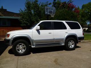

I have a stock 96 4Runner Limited 4WD w/ 250,000 miles on it. From the
ground to the bottom of the wheel well on the Driver side (front and
rear) is 34 1/2"; on the Passenger side (front and rear) is 34 3/4".
I drive mostly on the road, but go offroad occasionally. I have
265/70R16 Toyo Open Country on now. I have new Bilstein 4600s
for the front and back. I am thinking of buying new OME 881s for the front and 906s for the rear. I wanted 890s for the rear, but I was told that the
3" lift of the 890s may overextend the 4600s, and should instead think
about going with 906s + 10mm trim packers in the rear. I would like a
little lift more than stock coils. So, my question is: from what I
have explained, would the 881/906 be a good match for the Bil 4600s. If not, which combination of springs (and any other ancillary
parts) would you recommend to go with my 4600s? Thanks for the help.

I decided on Bils 4600s with OME 881s in the front and Bils 4600s with OME 890s in the rear. The rears were much easier than I thought they would be. The driver side came right off by hand after I got a wrench on the top nut. The passenger side was stubborn. I tried a pipe wrench, but no go. So I draped a towel over the exhaust to shield the shock from the gas tank, and I used my 3" Harbor Freight cutting wheel to cut the top of the shock off. That worked just fine. Before I started the cut, I sprayed the whole back area with a Windex spray bottle filled with water. No problem. Got it all buttoned up, and it looks great. I am not going to drive it until I get the strut bushings installed, and then I will take it to the dealer for a 4 wheel alignment. When I put the front wheels back on and let it down, the front and back end links lined up just fine. I had no issues with brake lines being too short, or anything else. After measuring through the center line on the wheels, I got a solid 2" lift in the front and a 3+" lift in the rear. It has a front leaning rake, and I like it. The measurements below are in inches. I would post photos, but this forum has a very strict sizing policy and it is a PITA to get my photos that small for posting. I don't have the patience. the measurements below are all in inches. Thanks for the encouragement.
My 4Runner - Before
LF - 34 ½ / 5 ¾ RF - 34 ¾ / 6
LR - 34 ½ / 5 ¾ RR - 34 ¾ / 6
After installing Bils 4600s and OME 881s up front and 890s in back
LF – 37 / 8 ½ RF – 36 ¾ / 8 + 2 – 2 1/2
LR – 38 / 9 RR – 38 / 9 ¼ + 3 ¼ - 3 1/2
