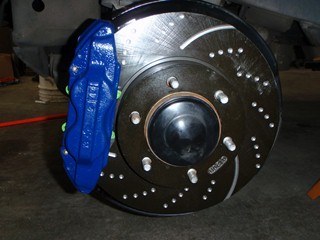

With the upgraded calipers and rotors how's the brake pedal travel? Same as before?
How'd you get blue calipers? Paint em? Looks good.
Old Jul 16, 2010 | 12:12 AM
  #203
frederickg's Avatar
Joined: Apr 2003
Posts: 24
From: Washington
Big Brake Upgrade Caliper Color
I used the VHT Cleaner and then used the VHT paint for brakes.
They had several colors at Autozone and I decided to go with the blue.
Used the hot weather we had here last week to paint them and let them bake in sun for a couple of days.
Paid only $8 for the cleaner and paint so I can't complain.

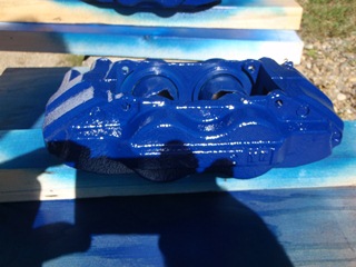

Any advantage to powder coating brake calibers?
I'm planning on upgrading the front brake rotors in my 97 Four Runner to the Tundra model and I've read a few threads where the front calibers were powder-coated prior to installation. While it might look nice, wouldn't this inhibit heat dissipation? Thanks
Old Apr 28, 2012 | 11:28 PM
  #220
frederickg's Avatar
Joined: Apr 2003
Posts: 24
From: Washington
Painting vs Powder Coating
Unless your going to be driving through salt water daily or live near the ocean I don't think the powder coating would make a big difference.
I'm sure there are Powder Coating Materials that dissipate heat well but Autozone carries the cleaner and the paint for $15 or less and you can be done in a couple of hours.
Since I bought 2 cans of paint I even pulled off my drums and painted them to match.
I sprayed mine with several coats and a couple of years later they still look great, other than a little dirt.
One of the best upgrades I've done. No more shimmy, shake or squealing.
See Pictures
