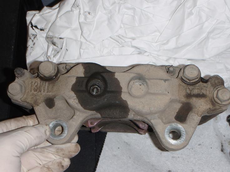

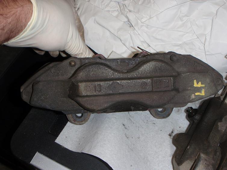

1998 4Runner Brake Upgrade
I have a supercharged 98 4Runner with IPT upgraded valved body and transmission cooler.
I pull a 6000lb boat & trailer I need to have to best brakes possible up front (even though the trailer has 4 wheel disc brakes as well).
My front brakes used to do the shimmy shake only when I would turn and brake at the same time.
Now it happens even when going straight and braking so I decided to Get R' Done and get the bigger Tundra Calipers.
I ordered the Bigger 231mm Calipers from Josh at Nix 99 and the first time I received the smaller S13WE 199mm calipers instead.
He told me he tracked down a pair in Idaho and sent them to me.
When I opened the box I noticed the calipers had 13WL stamped on them and not S13WL.
Does any know if theses calipers will work?
I'd hate to get everything on my truck apart only to reinstall it all again.
Your help is greatly appreciated

The Type B Caliper (231 mm) has the 13WL stamp while the Type A Caliper (199 mm) has the S13WE stamp.

13WL along with some OEM pads and decent rotors and you will be good to go. Check your brake likes while under there.

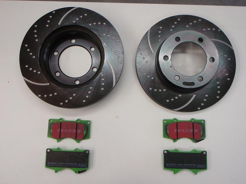

Rotor & Pad Questions
Well I got the calipers cleaned up and ready for paint
Now I need to order the rotors and pads.
Any Recommendations?
I noticed that some used slotted and crossed drilled rotors.
What the best place to order rotors and pads from?
What year Tundra should I tell them I have to make sure I get the right parts?
Thanks again for all the input

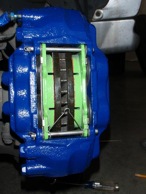

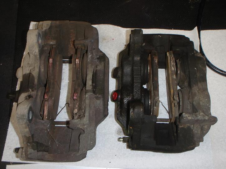

Finished Big Brake Kit on my 98 4Runner
Well I finished installing the Big Brake Kit.
Pretty simple installation. Even got my wife to help me bleed them
All I can say is WOW!
No more shimmy or shake and I'm so glad I did it.
Purchased the Calipers from Nix 99
Purchased the Discs & Pads from my local Westbay Auto Parts.
I was able to upgrades my brakes for a lot less than the stealership was going to charge me to replace them with th same problematic discs and rotors.
