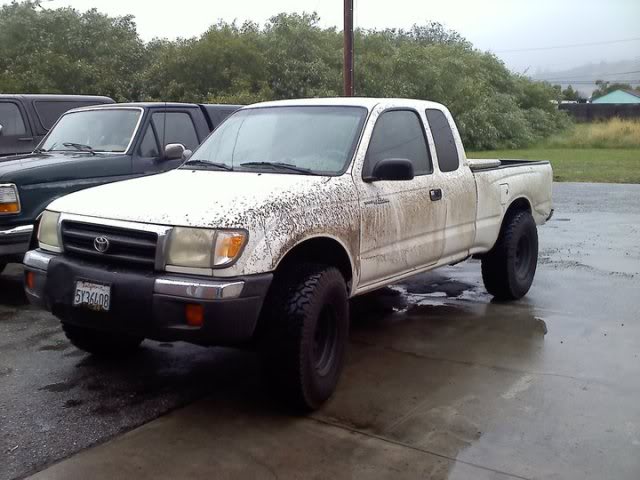

Does this this truck look like it wants too sit?? =( I mean just look at it! it wasn't made too sit for not even a week. it has 240,000 miles on it never any serious problems and a spark plug change brought it down. people are now telling me that the wrong spark plugs threw everything off and fried my wires. I look around the truck's engine compartment and there's little signs saying to only use the dual electrode plugs. It's all over the manual too.. I guess I never caught on too that now I have a truck that's out of time and possibly, most likely has some fried coils and fried spark plug wires. I'm hoping that's the worst that happen I guess after a diagnostic check we will know for sure. hopefully next week I'll get it checked out. again, thanks for everyone for trying to help

The single electrode plugs of themselves did not cause your issues. Hope you get it back on the road soon.
