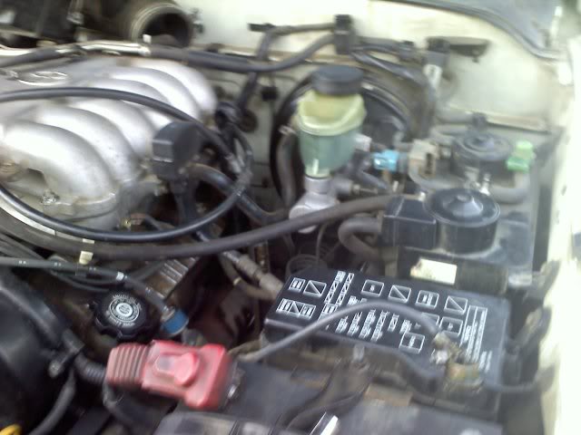

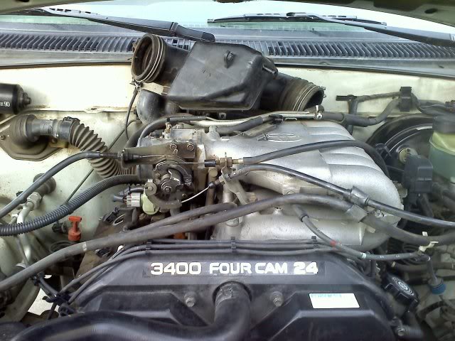

one sec let me get some pics

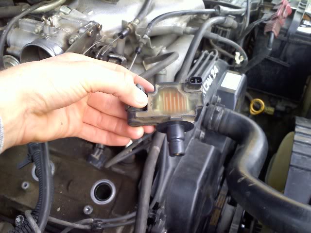

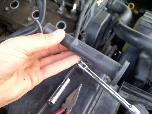

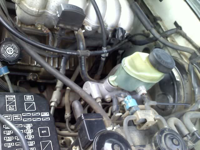

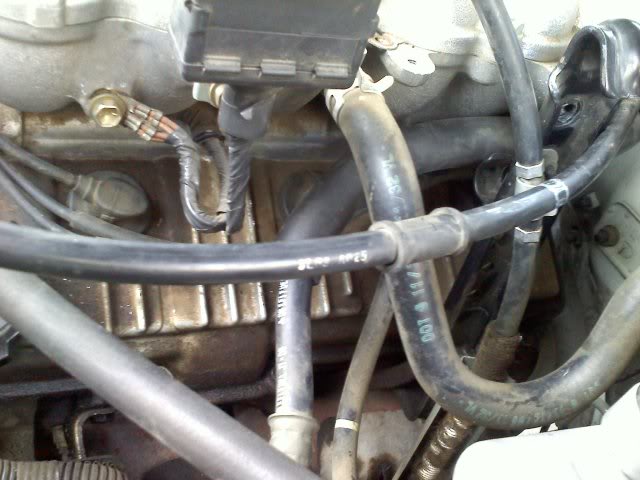

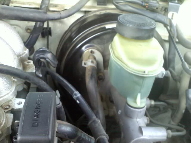

Posts: 34
Note - this is all the pictures from when I had everything undone. I bought new plug boots and still no luck =(

Haven't had that problem on my 3.4 but I'm no expert.
Should I mention the battery cable or are you frazzled enough?
Where's the anti-seize on the new plugs? (lack of wouldn't create your situation)
How about a pic of the plugged in MAF for grins?
You've been plugging the coils back in, as well as putting the boots on, I'm sure.
Can't see the last boot on the driver's side rear of engine- good there?
There's an assortment of loose vacuum lines on the right hand side (passenger), all belonging to the intake tube and its knick-knacks. Assuming you had that all buttoned up when you tried to start it.
There's an electrical connection (the only plug with wires going to and from it) on the front of the timing cover, passenger side you can just see in the 1st pic of your second to last post below and off to the side of the power steering fluid reservoir....there's no reason to unplug it but who knows, your truck won't run if it's apart, is that plugged together?
Old Jan 3, 2012 | 04:10 PM
  #32
Mikey410's Avatar
Joined: Jan 2012
Posts: 34
