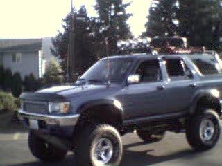

Heres a shot of it lifted from the side.
Attached Thumbnails The Big Bad Blue 3" Body Lift Drama-7-inches-lift-side-shot.jpg

That thing is HUGE!!!!!
Thats what I said when I saw the pic but still looking good.
