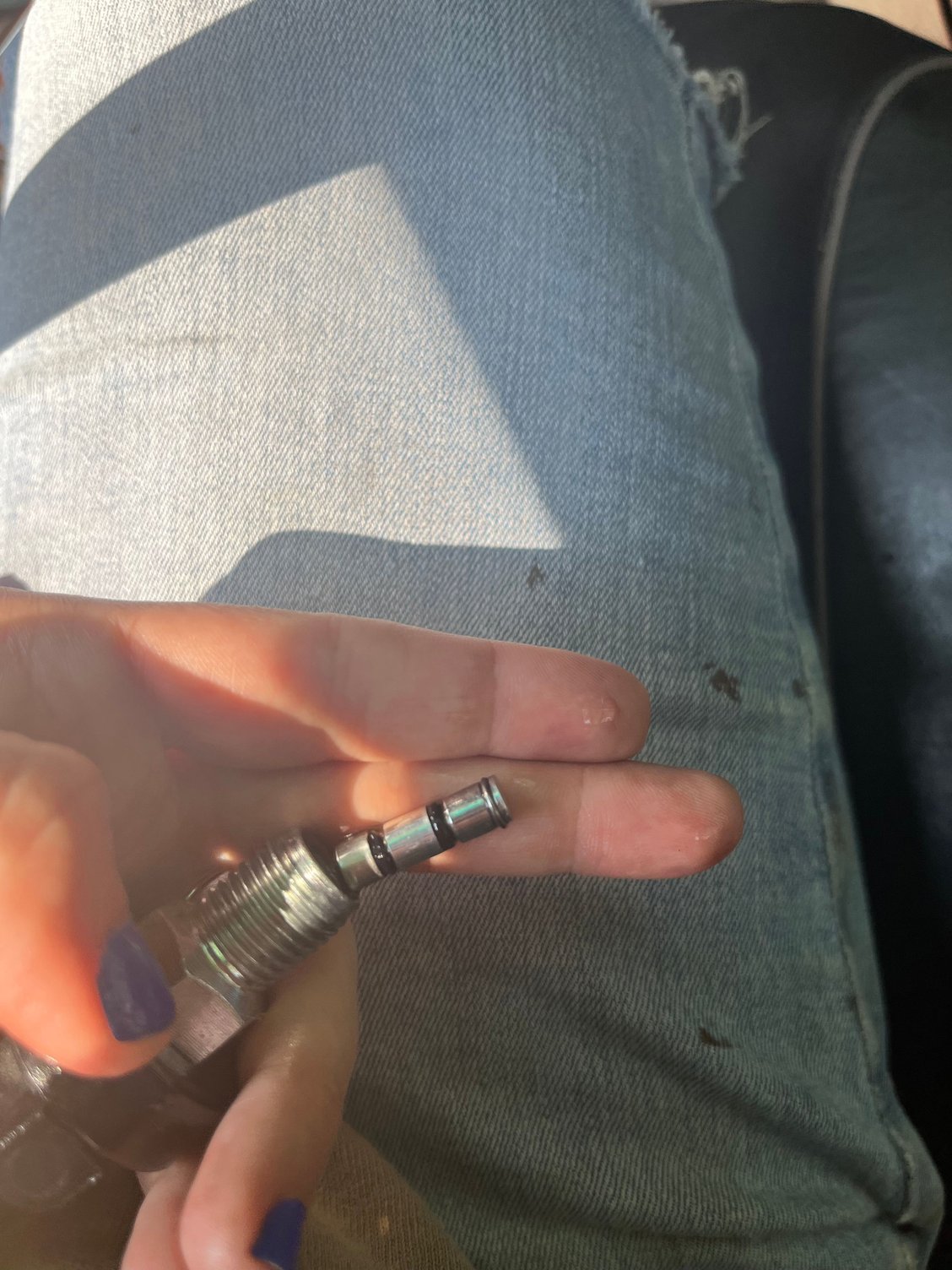

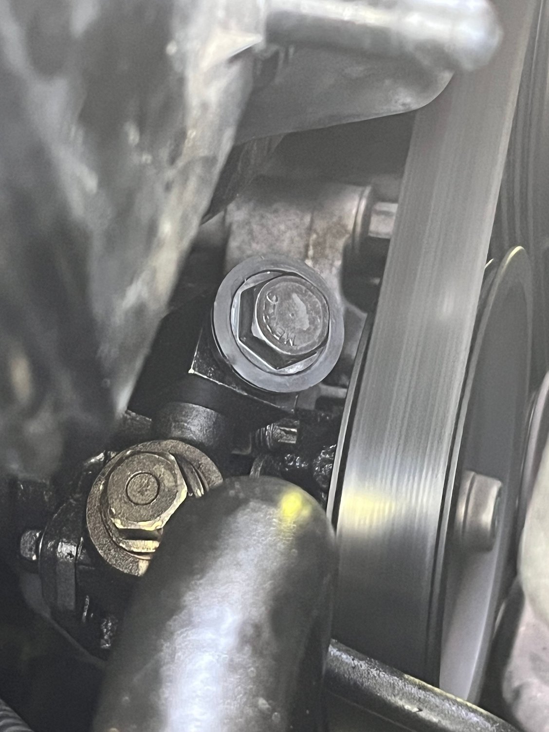

I know this thread is a few years old but my husband and I wanted to come on here and let everyone know, in our 03 Lexus gx470, we stuck a bolt in it from a Honda oil plug, 14mm/1.5 threaded it in with pipe tape, and it has worked perfectly. Can’t tell any difference to be honest. You’ll need a 17mm crow foot to get it out. You’ll also need 2 vacuum caps. One one the breather box and one on the intake.
