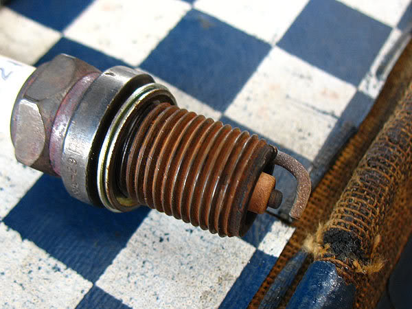

After you loosen each plug a couple of turns, take a shop vac and suck out any debris to keep it from falling in the combustion chamber. The photo below is a good example of why you should use anti-seize.
