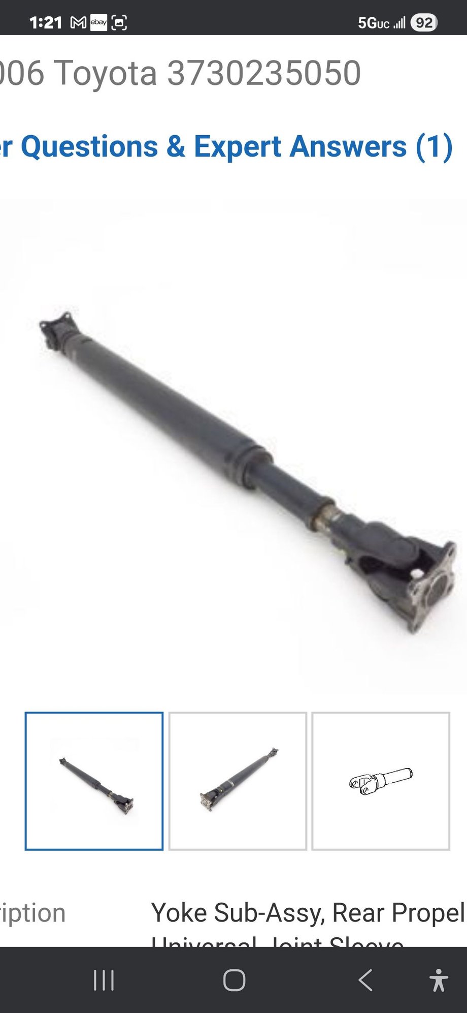

I did find this if that is what you're referring to.
Toyota 37302-35050 Universal Joint Sleeve Yoke Sub-Assembly $191.50
How do you determine if the sleeved yoke assembly is going bad? There doesn't seem as though there is any play in it.

Ok, there is a difference between slip yoke vs slip joint, if I understand 2WD correctly you have a slip yoke that slides onto the rear tail of the transmission like in the 1st pic of the link below I realize its 2nd gen but should be similar to this #37302-24010 it has rubber inside of it that wears out.. A slip joint is on the rear of the drive shaft for the 4x4 like the part # 37302-35050 and allows the driveshaft to slide together and has fixed yokes at the transmission and 3rd member., I could be wrong as I'm not well versed in 2wd prerunners more 4runners so please provide a picture of your driveshaft, but even the 2wd 4runner had a slip yoke at the transmission, unlike 4x4 that have a slip joint built into the rear prop shaft.
https://www.tacomaworld.com/threads/...eshaft.729413/

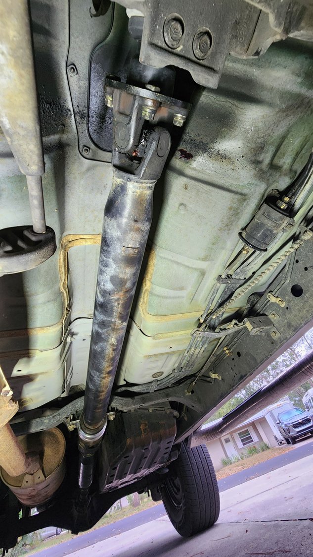

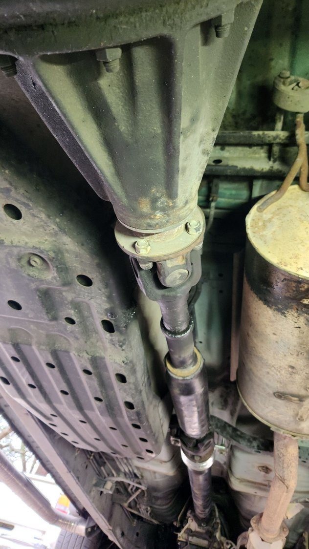

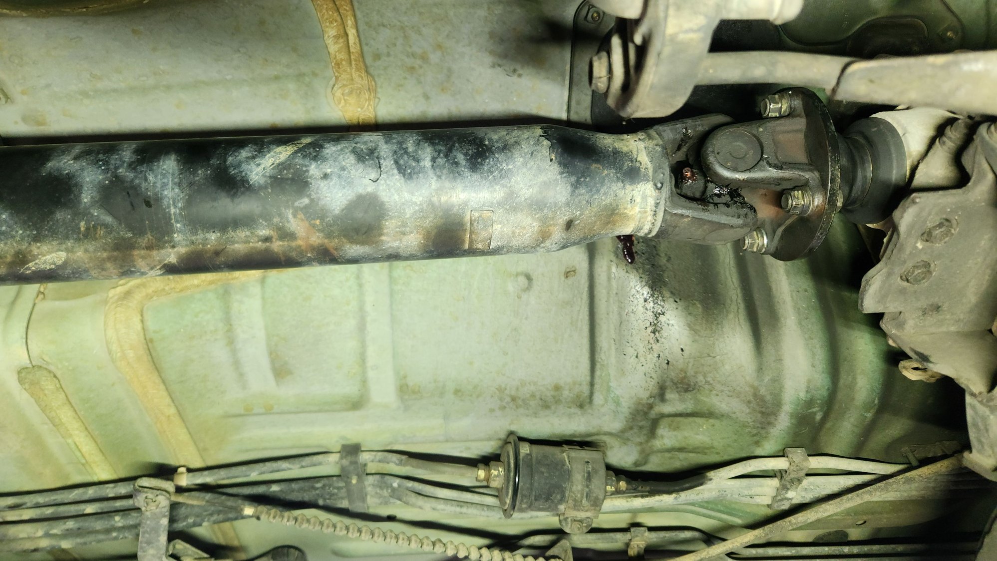

Rear 3rd member and sleeve/yoke side
3rd member to center support bearing
3rd member and sleeve/yoke bottom

The slip yoke at the transmission tail, not the slip joint at the 3rd member in the driveshaft, the slip yoke at the transmission of the 2WD has rubber in it, it is an issue, unless you have a fixed bolt on yoke at the transmission, but my understanding is the Prerunner has a slip yoke at the transmission..
EDIT: and it looks like your U-joints are out of Phase, so when the Driveshaft slip joint was separated they didn't line up the splines and u-joints, the u-joints should be aligned perfectly like in the generic photo included, that alone would cause a vibration for sure, I'm surprised they used a double cardan joint and a carrier, must be a double cab thing, the 4runner 2WD has a solid shaft with just a slip yoke at the transmission, but isn't as long at double cab Taco

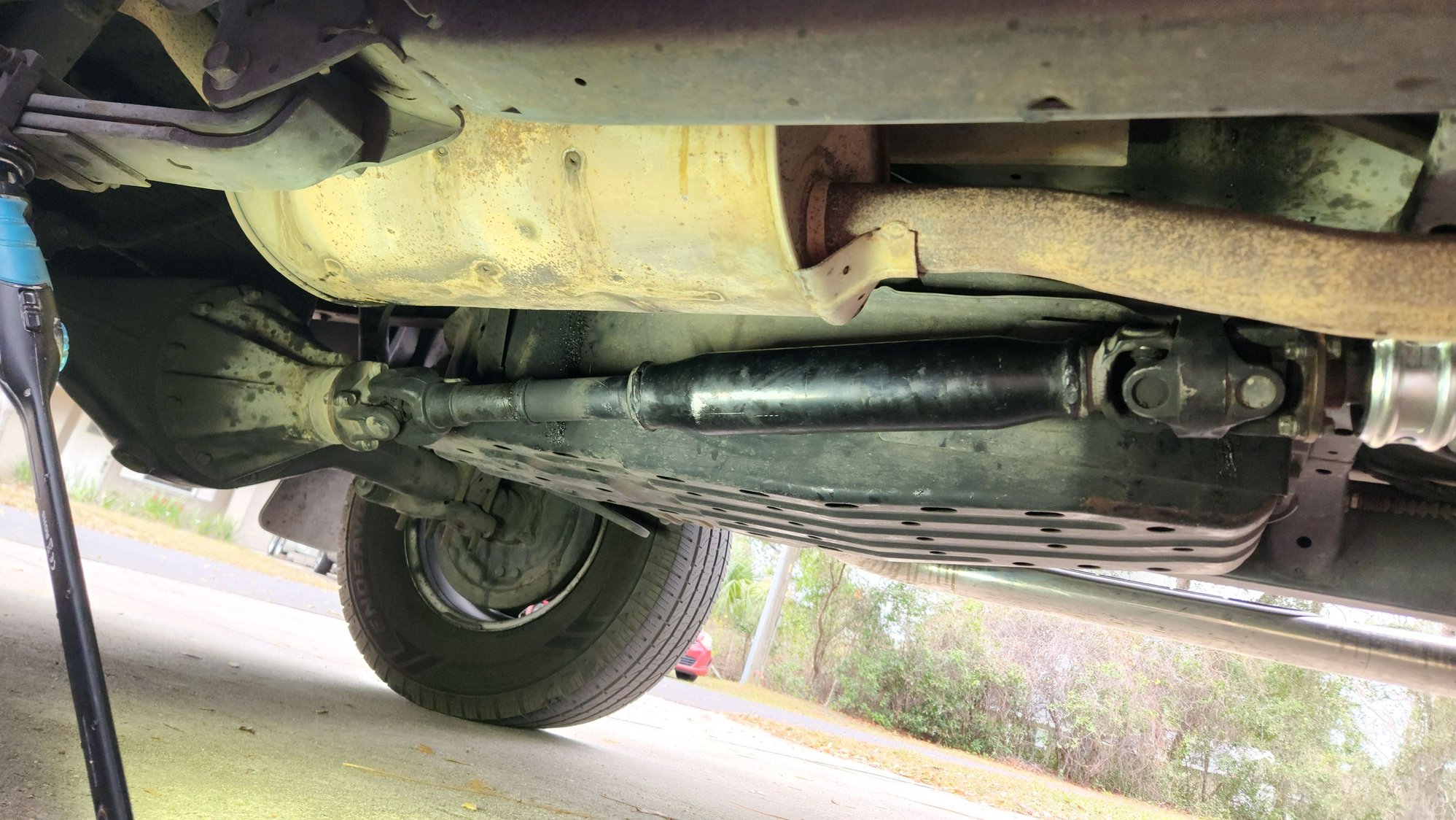

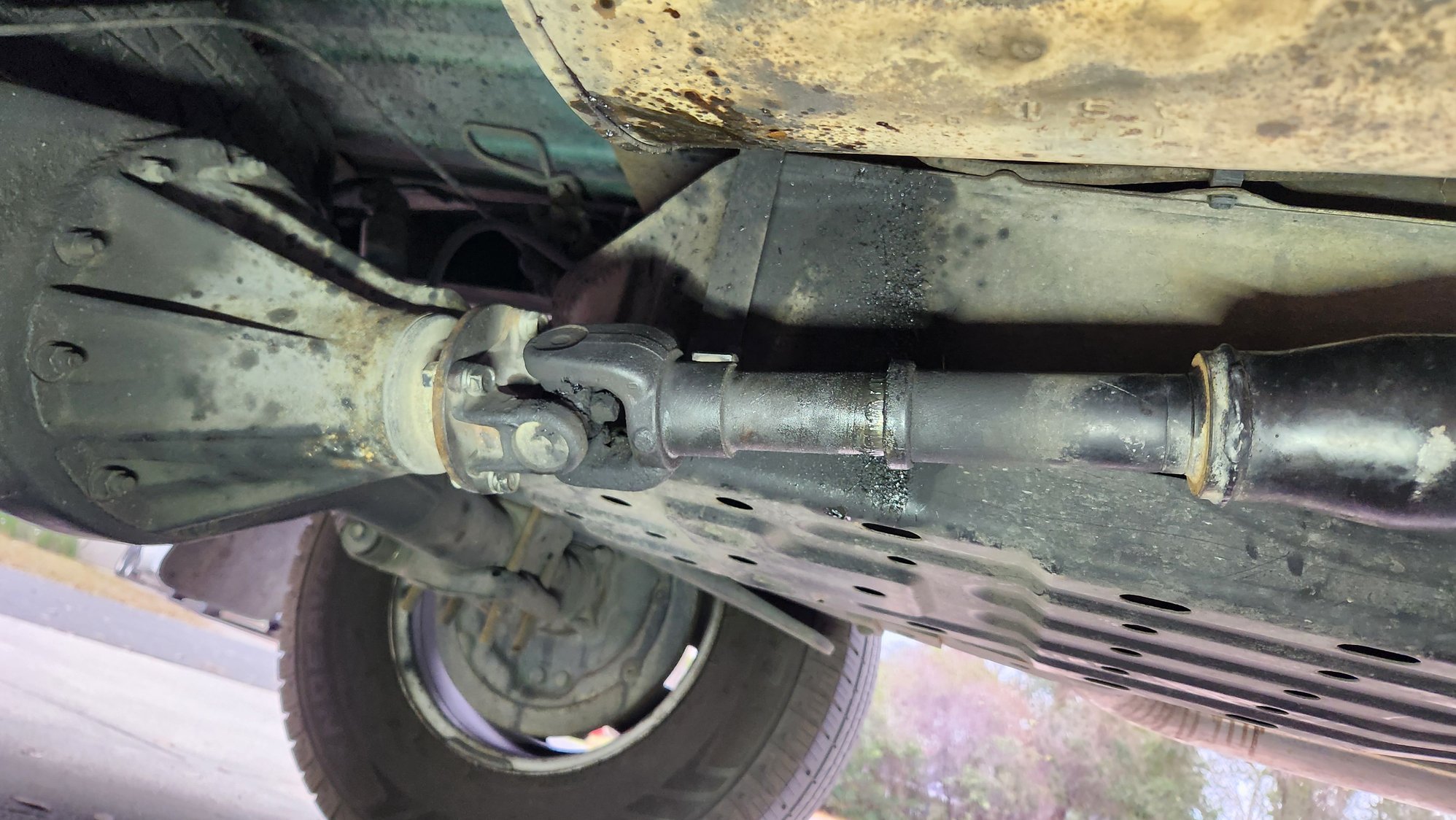

Yes, I noticed the misalignment while under there, as well. Yoke slipped out on removal for center support bearing. That will be remedied shortly. The vibration didn't worsen nor improve despite that.
As for there being a slip yoke at the front, negative.
Front drive shaft side
Front drive shaft beneath

Very interesting they used a 4x4 driveshaft and fixed yokes on a 2wd Double cab pre-runner, so no slip yoke at the trans for you got it., I don't see a rear e-locker, so non-abs, no e-locker, 4:10, learn something new everyday. Unfortunately these vibs can be difficult to trace down, a camera on that carrier bearing or other joints to see if its moving would help, other wise swap driveshafts, re&re rear wheel bearings and inspect axles, then determine if you wanna call ECGS for a new 3rd member, if you want an e-locker, you will want to hunt down a non-abs complete axle and housing ideally, you can use the ABS rear axle housing and just leave the sensor installed to plug the hole, there are kits for e-locker add-ons for toyotas. You should be able to fit any 4x4 or 2wd rear axle 1995.5-2004, most of the Taco 4x4's will be 4:10 or 4:30
EDIT: does that 4 bolt flange slip out of the 2wd transmission out of curiosity or is it fixed with a staked 24mm nut?, just curious if it has that slip yoke like the 2wd but a 4-bolt flange..?

The front yoke is staked.
No plans for an E Locker. I think my next move will to replace the U-Joints even though they all felt fine. They are original so they may have just reached their limit.
