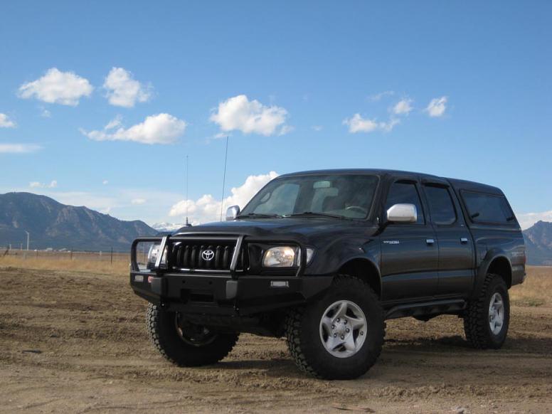

Hey I am thinking of upgrading to Tundra coils, currently running 881's in front. When I put my ARB on the front dropped about and inch, which isn't so bad but the front end feels really squishy now, I miss the tighter handling before the ARB. Do the Tundras give a little stiffer ride?
sorry, still searching and learning kind of an IFS noob here... ask me something about a Land Cruiser. here's a pic, though not a good one to see the rake

love that double cab nakman with the new ARB
Not sure of the fitments to a 'Coma but I think Scott-JadeRunner is running Tundra coils.
Not positive but I think the TRD Tundra coils are particularly coveted,
