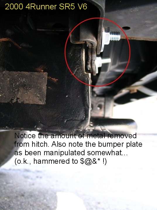

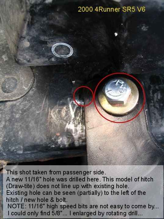

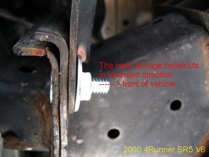

installed a Warn front mount hitch receiver on my Hilux Surf last weekend. It's a direct bolt on (snug-fit) but there's a need to drill two holes (1 per side) on the rail. There's also a need to reinstall the tow hook on the right side or you can have a thick washer fabricated instead. The Warn kit came with bolts, nuts, and washers.
With a fat-lip bumper, the receiver is so far away from the valence and I think there might be enough space for a winch in there...
on the downside, there's a need to relocate the TRD ATF aux. cooler because the hitch will hit the lower mounts of the cooler. A fab shop can easily make new mounts for the cooler, locating it an inch or so higher than the TRD position.
