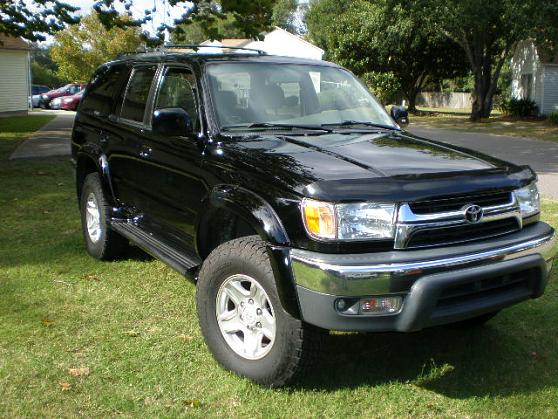

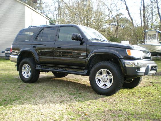

After many months of researching I finally did the TRD coilover lift on my 2002 Runner. I had been running the OME rear coils and shocks with the cone and gained 2.5" solid. I installed a 2.5" Daystar up front that I had sitting around for a while. It did not give but about 1.5" lift and the truck sat raked pretty badly. After the shocks went bad I decided to track down a set of TRD coils and found a set on Tundra Solutions for $125 with the yellow Bilsteins.

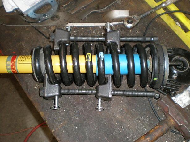

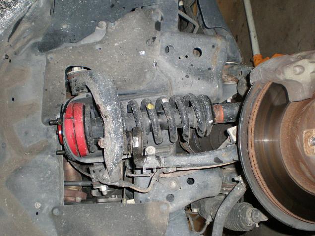

The pics below show the installation. It took about 6 hours hungover. Probably could have taken less not hungover, but it was the weekend!

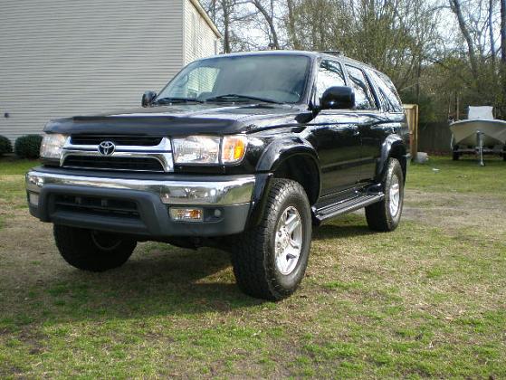

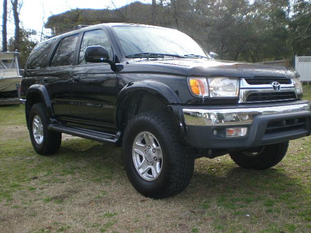

The truck went from about 36 1/4" from the ground to about 37 1/4" after the alignment. As you can see in the after pics, it sits completely level on all 4 corners with even 2.5" overall. I added a 5/8" Revtek top out spacer and 1" diff drop as well from Wheeler's(great guys). I must also ad that the yellow Bilsteins are AMAZING!! The truck rides almost like it did stock with the 4runner springs, but is a tad stiffer and corners much better. It is a VERY plush ride. I don't see how any other shocks could ride much better honestly. My truck is shown before with the daystar lift next to my brother's '94 runner with 2.5" Downey torsion bars and coils. Hope y'all enjoy.
