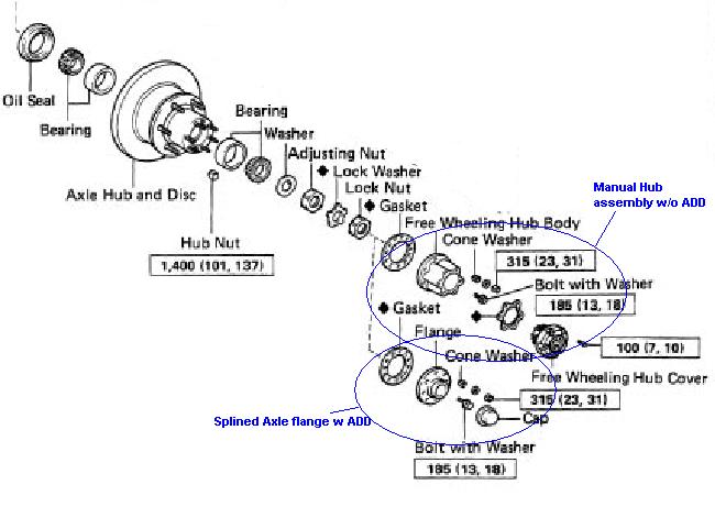

Exactly. So you can have the convenience of pushbutton 4x4 (actually pull lever 4x4) on the fly, and ALSO you can have 2wd without the axles and joints spinning.
Old Nov 29, 2004 | 09:42 AM
  #37
Flamedx4's Avatar
Joined: May 2004
Posts: 3,291
From: 100 miles offshore as much as possible, & Springfield Oregon USA
Originally Posted by nastynate
what's the difference between manual CV's/spindles and ADD CV's/spindles?
i know (i've heard) the ADD CV's are beefier, but how does it improve the angle problem?
None. Same part number.
The difference is the hubs themselves, and the ADD sleeve inside the stub axle. But the drive axles are the same with either system. The outer end of the shaft either slides into a simple splined flange and so spins all the time, or slides into the manual hub assembly and can be unlocked. Either way the inner end bolts up to the axle housing flanges.
Hubs:
Hubs:
thanks for the info!!
