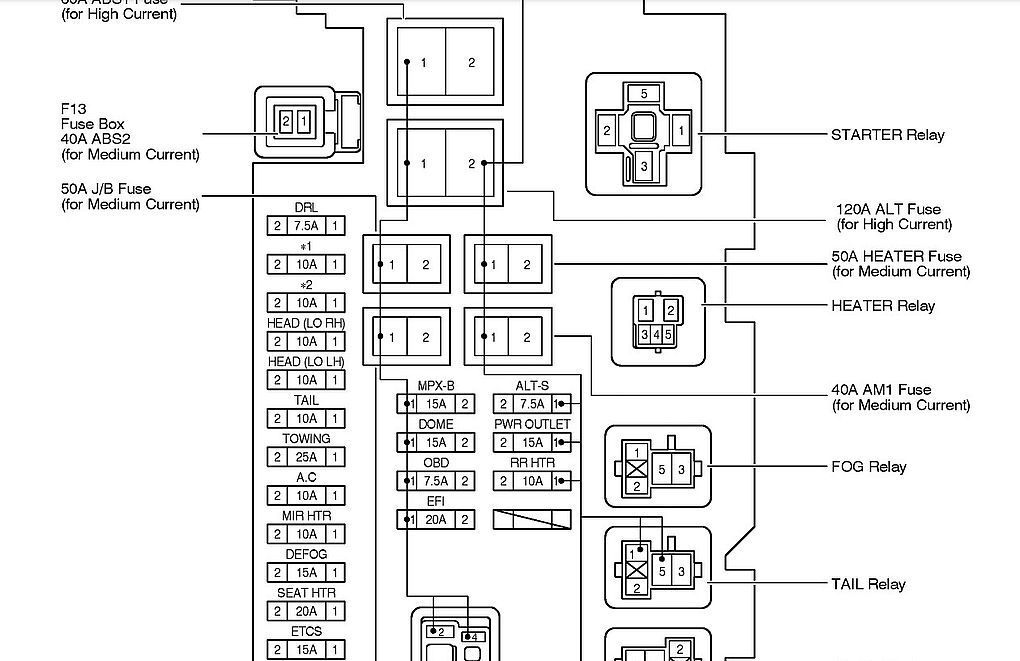

I'm not sure what the heater control relay is or where to find it.
It's in the same fuse/relay box the AC fuse is located in. Here's a picture of it:
Hope that helps.
