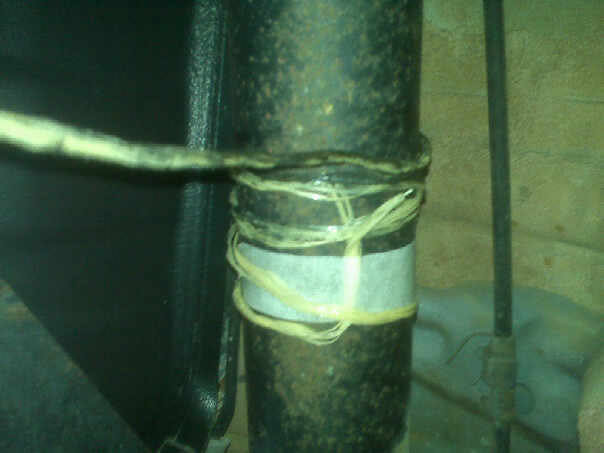

ok, so I verified that I have 4.10 gears by placing the air valve on rear drivers side tire at 6 o'clock position and then taping a piece of thread with a weight at the other end to the drive shaft and then rolling the 4runner forward until the valve was again at the 6 o'clock position and then counting the number of rotations of the drive shaft which I measured by how many times the thread wrapped around the shaft.
now to find someone who has done a swap like this, to 4.56's or 4.88's and also to install an aussie locker in the rear. From my understanding I need to swap out my front diff gears too so that they match the rears.
