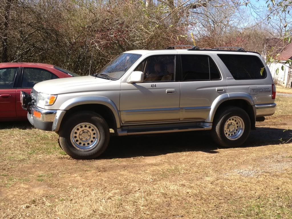

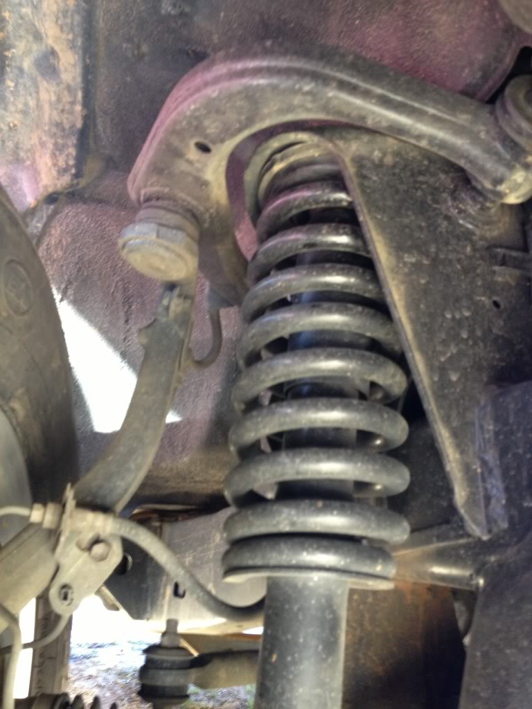

I found some 99 tall coils so i went to count my coils and they are the same. They have no color marks on them but they count out right. What do you think? The front from the ground measure 34 1/4" the back from the ground measure 35"

My 2000 has 265/75 R16s and before my lift the bottom of the fender to the ground was 34" on all four corners. Not sure if that helps you any.

those prolly arent stock struts and coils then all the stock coils ive see have colors on them and if i remember right theres a blue strip on the stock struts too on the bottom, thats for atleast all the runners ive seen

It's on 265/70 16 . I know the rear springs were replaced by toyota in 2002. Not sure about the front, I know the front is firm. I think I may go with a spacer up front to level it out.

ohh then its deffinetly a 98 idk then. but i really wouldnt worry about the 3/4 in difference in height if any thing just get some bigger tires. and the ride in my runner is really hard and rough too but i need all new suspension because my stuff is rusty and tired

Here's a picture from Steve for comparison:
You can see that the 99 springs have the same number of coils as the 98, they're still taller though.

A pictures worth a thousand words, Thanks for the comparison pic.

I got a chance to pull our 2000 next to a 2wd 2002 and it appears they sit at the same height.
