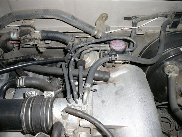

Hey guys does anyone have any good pics of the rubber lines that attach to the EGR valve on a 99 Tacoma 2.7L? I changed the cylinder head and cant seem to figure out where one of the lines that attach to the EGR went. Any help is greatly appreciated! Thank you Delano

I've attached a photo of mine ('99 2.7 California model). There should also be a 'vacuum hose routing diagram' on the under-side of your hood.

Thank you so much for the photo! You are correct about the diagram, however what I need is the two lines that are pointed towards the valve cover. I should have made that more clear in my original post. I believe they are coolant lines?!?

Your arrow is pointing to the EGR modulator, so I don't know what you mean by that.
The hose under the PCV hose I found on mine. Its about a foot long, and 's-shaped' with at least 3 formed curves. One end attaches to a fitting on the TB, and the other end to a fitting coming out of the cylinder head near the firewall. I don't know what its function is, perhaps to cool the TB.
