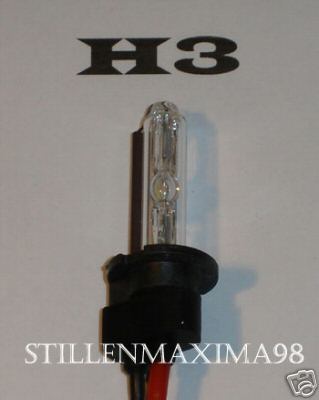

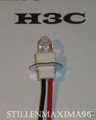

H3c vs. H3 HID bulb...
I may install the H3c HID bulbs versus the H3 bulbs to maintain the same focal point. By using the longer H3 hid bulb, my beam pattern and/or cut off maybe affected. Thoughts??

So you can for sure fit HID's in the Micro DE Hella's?
