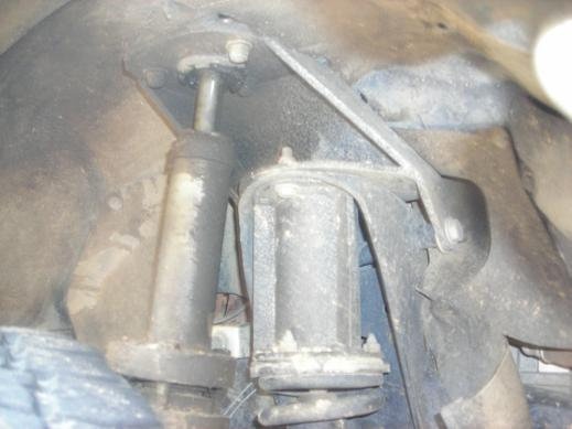

I have a 98 Tacoma with a 6" lift of an unknown origin (lift was on it when I bought it). I am concerned because there is very little clearance (about a 1/4 inch) between the tire and what I am assuming to be the strut.
my second question is, Should the strut still be on the truck even thought there is a coil-over shock on it.
I am not shure exactly of what I am looking at because this is my first Yota. If anyone could post a picture of what their stock suspension looks like or what their 6" lift looks like I would appreciate it greatly. I will try to post pictures of mine so you can point out if anything is wrong.

Here is what my lift looks like. It seems to me that there should be an upper A arm or something. Take a look ant tell me what you think.

Looks scary. You appear to be missing an upper A-arm that was replaced by some sort of strut. I hope you can find out who engineered that thing. Here is a link that has some pics of my '97 4Runner front suspension.

I have asked around and that appears to be an old trailmaster lift......dis-continued..apparently for obvious reasons.

Yeah, I found some receipts in the owners manual. Its a Trailmaster 6" drop bracket. I dont have any extra money to replace it so I will try to find some wheels with less backspacing instead.

That is bizzare!! The tire is close, too close for me. I wouldn't drive it like that but I would guess it has been driven and the tire doesn't look, from the pictures, like it has been rubbing. I would get a 1/4" spacer and toss it on to give a little more buffer. I'm suprised how little space you have to the bump stop. It must hit on every bump and dip.

Yes, its been driven, alot. I found some receipts that shows the lift being put on around 4500 miles. The truck now has 150K miles and I would assume that there was no problem or the previous owners would have fixed it. However, I think that I may be the first owner that takes it off-road.
Oh yeah, its rough too. Not much flex either. It doesnt hit the bump stops, its just plain stiff.

In the picture with the bumpstop, it looks like you are hitting the bumpstop, that is probably why it feels so stiff. Look at the top of the rubber stop & the metal where it contacts, if they look clean, you're on the bumpstops often. It appears that the lift just spaced the stock suspension down 6" as it looks like you still have the stock springs & shocks.

Yeah, Im hitting the stops. Thats why its so rough. I actually looked at the lift and I think the lift bracket actually gives me less flex than the stock suspension. Go figure.

Most of the time when a bracket lift (like you have) is installed, some cutting of the factory frame/crossmember is cut out. To go back to a non-bracket lift you would need to find a junker and cut out and reweld into yours. You would also need upper control arms since they have been replaced with the sliding piston that is on yours. UCAs shouldn't be a big deal. There should be some great/better than stock replacements out there.
Once you get the front back to "original" then you can do a coilover that will give you up to 3". If you want more lift than 3" then you have to stay with a bracket lift or do a solid axle swap.
Your least expensive option is to replace the coils with new/taller coils. That will get you off the bumpstop. You may need/want to lift the rear to get back to level.
As far as the tire clearence, either go with a 1/4" wheel spacer or different wheels with less BS.
PS. Yes you are hitting the bumpstop. Look at your picture. The rubber bumpstop is rubbed black from hitting.
