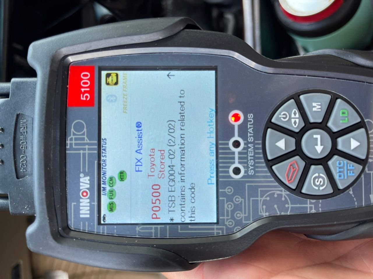

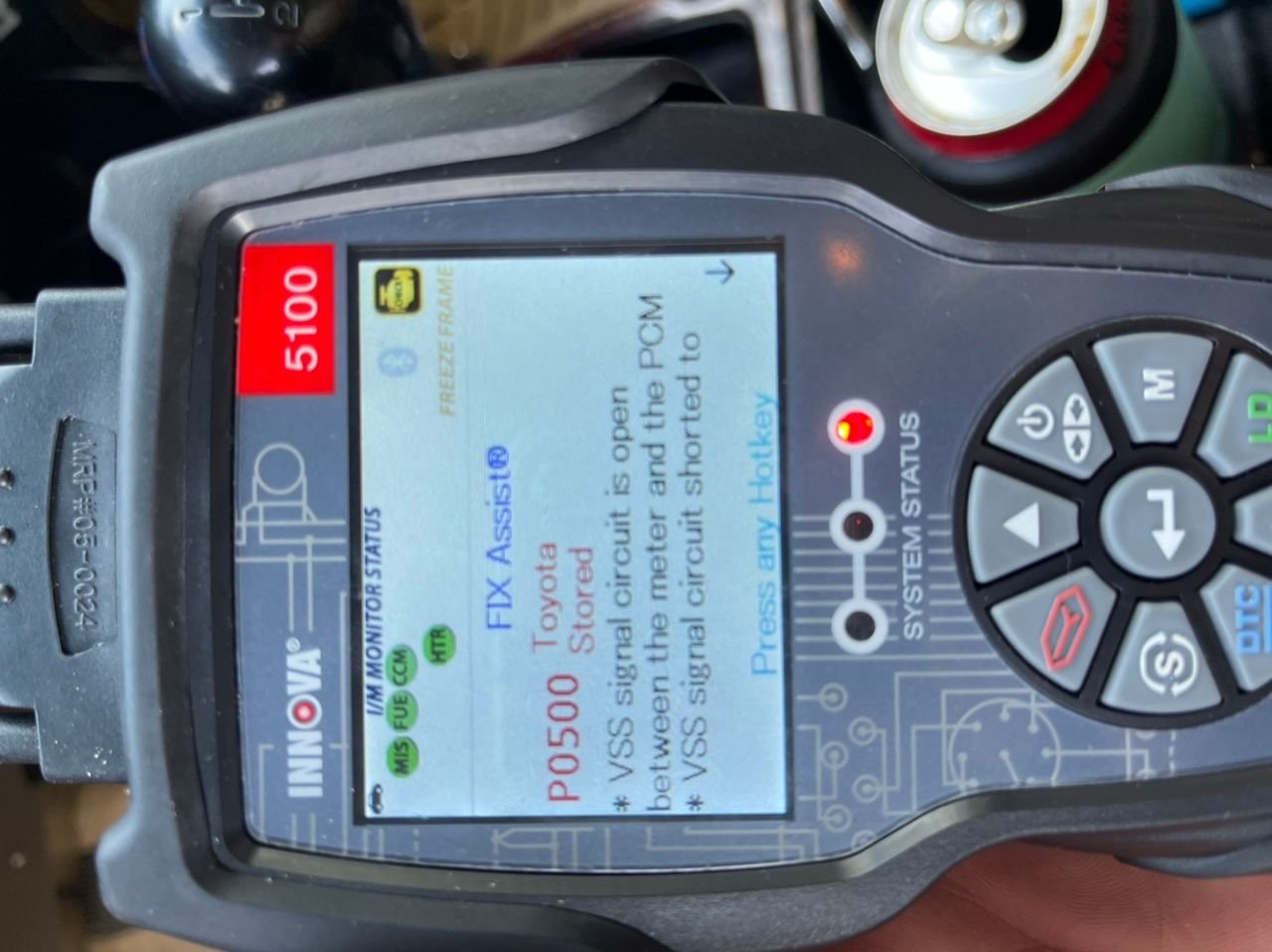

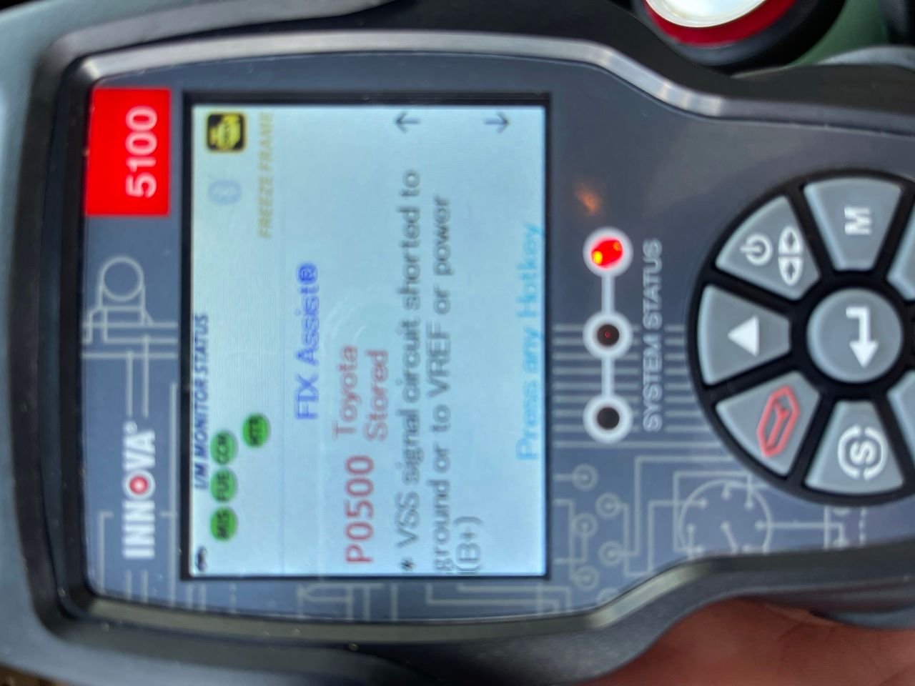

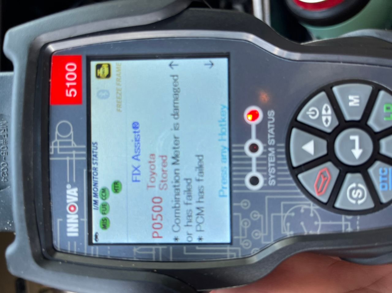

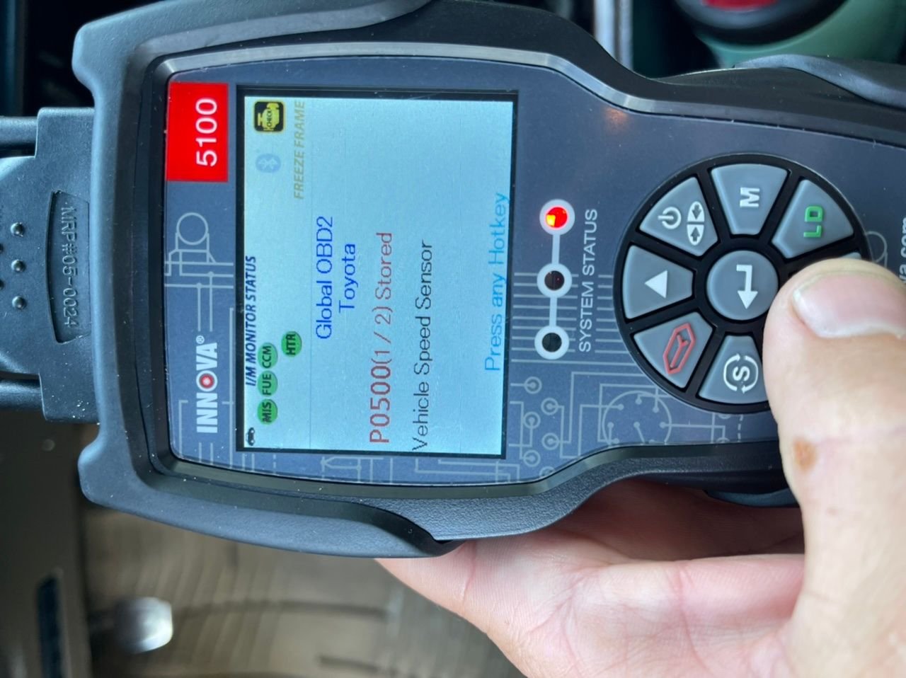

I have a 98 T4R manual 4x4 with abs codes 31 33 34 49and a check engine light that returned code p0500. Speedometer it intermittently not working. Attached are pictures of the scanner. I’ve already cleaned the three wheel speed sensors and still nothing. Please advise next steps.
