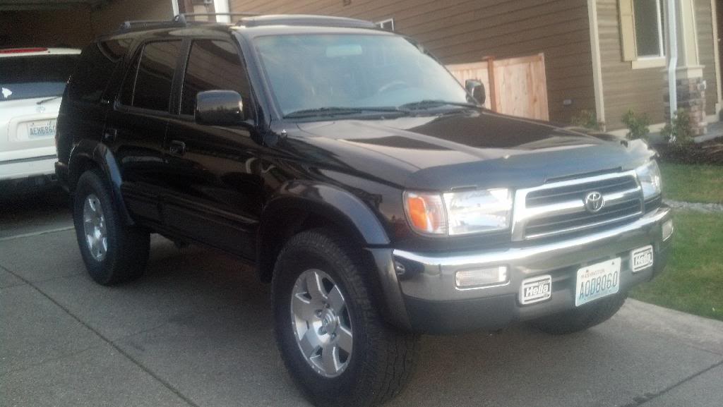

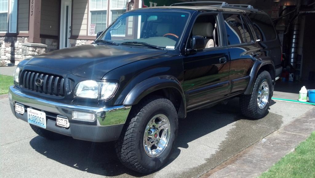

Here's a picture of mine before and after. My before picture is what your after, but with the sport hood
BEFORE

AFTER

Great job on your conversion. Someone who doesn't know Toyotas would never know that it did not come that way. Looks factory to me.
