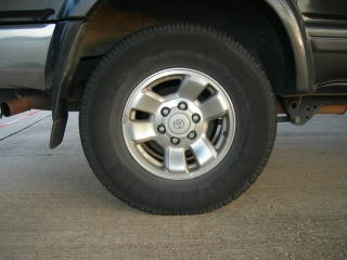

I guess where I became confused was I assumed the 265-75-16's were stock when I bought it used...turns out they trimmed out some wheel well, and they have never rubbed. so that's going to be the magic size for NOW anyway...will new tread fill the space out even more?

Yah new tread will really help it out. My old toyos compared to my new ones is one hella difference
