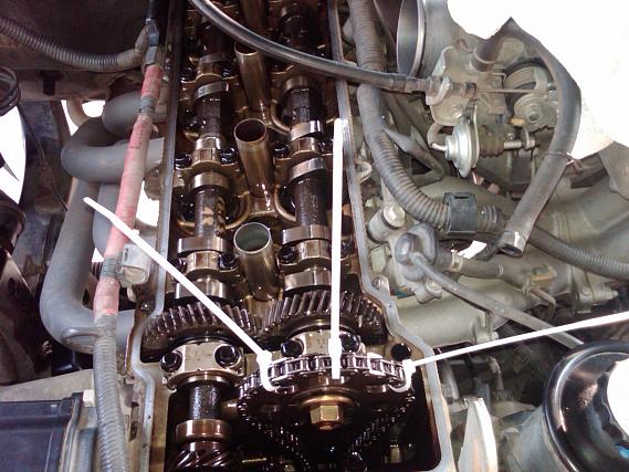

Spoke with another tech and he suggested I look at the valves since it will run with open exhaust frequently.
Purchased a feeler gauge and the exhaust reading was supposed to be .010 - .014
My results:
Valve 1 =.08
Valve 2 =.07
Valve 3 =.08
Valve 4 =.06
Valve 5 =.08
Valve 6 =.08
Valve 7 =.07
Valve 8 =.08
After doing research I found out that there is Valve Shims. I pulled the CAM and removed the shims. All of these measured .113 inches / 2.85 metric
My results:
Valve 1 =.08
Valve 2 =.07
Valve 3 =.08
Valve 4 =.06
Valve 5 =.08
Valve 6 =.08
Valve 7 =.07
Valve 8 =.08
Next I purchased the new valve shims from dealer and replaced...

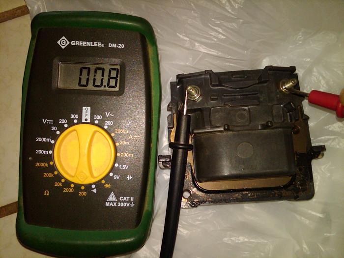

I pulled the coil from the distributer and it is reading Primary .8 and secondary 12.7 so according to the manual it is good. I called the Tech at Toyota and he said the magnets in the distributer go out on these trucks. I am soooo tired of troubleshooting this...
Is there a way to test voltage/resistance on the distributer itself and not the coil? IS it true about the magnets going out on this model? Any thoughts and advice are appreciated. I just order the new distributor $255.00 and I can return it if I do not install.

check the voltage coming out of the alternator look for about 13.6v any thing over 12.5 should work but if at 12.5 or lower new alternator is recommended,
as for the distributor no the spark comes from the coil through the distributor best you can do is a visual inspection... check your fuel pressure again...

Still no check engine light? Why would the alternator voltage play a part in this?? I will check the voltage.. Do I check with the ignition ON or OFF? Also I tried crannking the motor and pulled the distributor cap off and see week spark coming off the Rotor...
The 02 sensors and also good...
